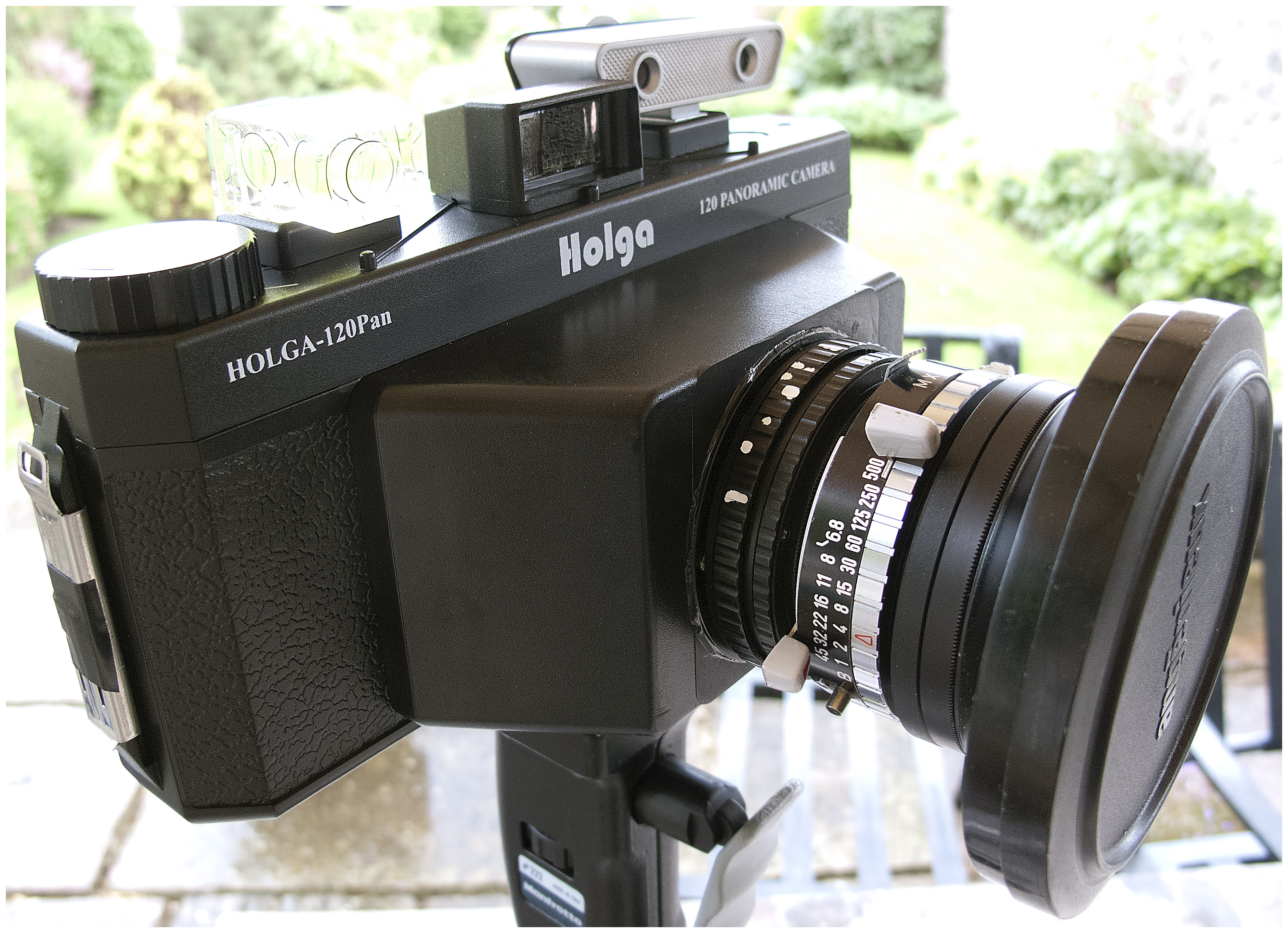

Hey all, this is a question for anyone that has done the mod, I've just put everything together and have hit a little snag. I can't get the camera to focus at infinity...
I used the same components as in that pdf Regular Rod mentioned, a Nikon to M42 adapter mounted clean to the front of the Holga body, 12mm-17mm helicoid, M42 body cap drilled out, but then a Graflex Optar 90mm lens which I got for cheap instead of an Angulon.
With the helicoid, at f6.8 I would say I'm focusing from about 3m far to 0.8m near, but distant objects are definitely out of focus against the test ground glass. If I remove the helicoid and move the lens back by 4-5mm then distant objects appear in focus on the ground glass. So I don't know if the optical centre of the Angulon lens might be a few mm back compared to the Graflex, or are people just stopping down to f22-32 to get things in focus?
I shot a test roll of film at the weekend at different fstops but then flashed the film when loading it for development and it was the last roll I had so need to repeat all of that.
Any pointers or tips would be great, there's a cheap'ish Angulon up for grabs at the minute but don't want to purchase that if it has the same problem....
I've ordered a 7mm M42 macro ring as a test to replace the helicoid which will drop the lens back 5mm, then maybe just have it as a fixed focus camera. The other option would be to start completely removing the front of the camera, or try and mount the nikon/m42 adapter inside the body somehow.
Thanks for any help!
