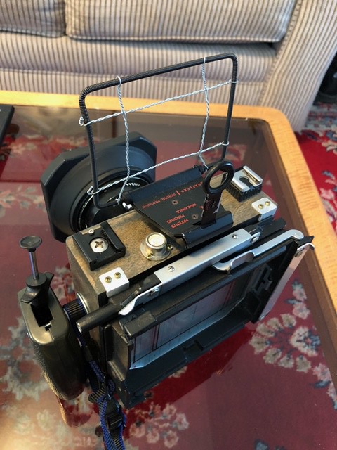

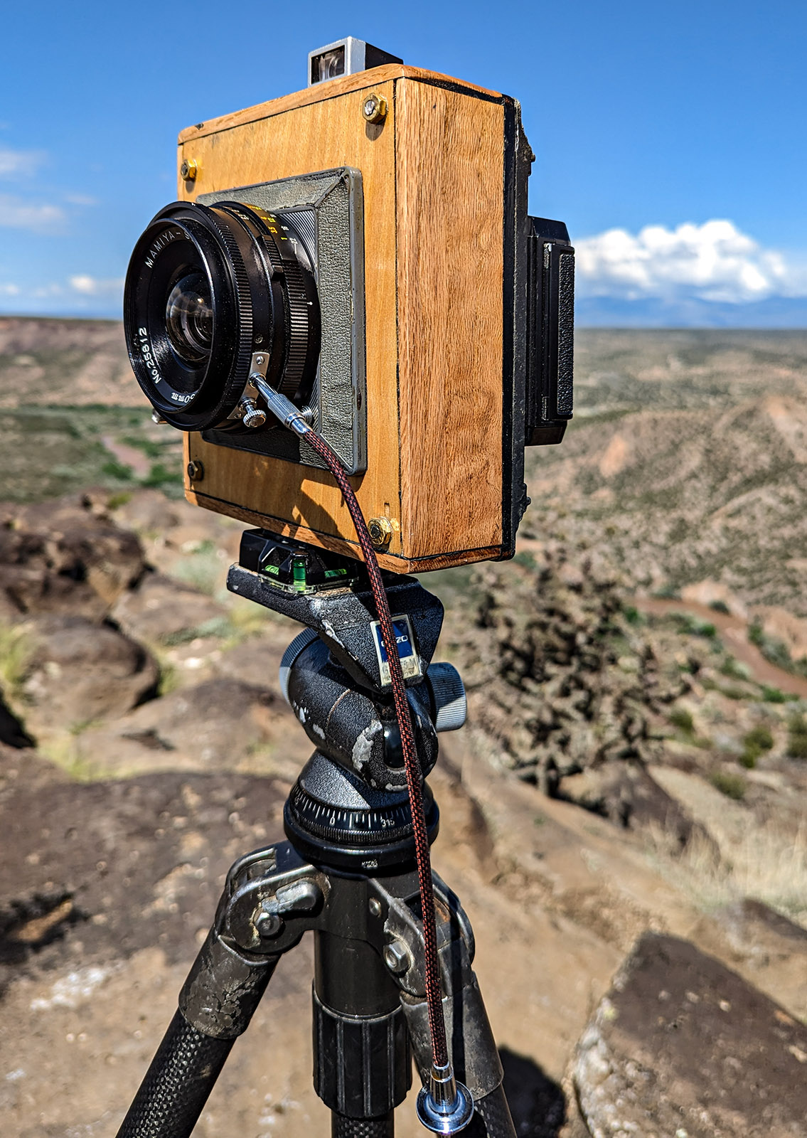

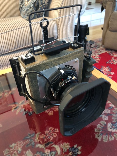

The last camera build I started before I left Indiana was designed to use the lenses from the Mamiya Press in front of 4X5 film. As you can see from the picture of my living room here in New Mexico the lens really doesn’t cover the area of 4X5 film well at all. So, while the actual camera build was good, I didn’t use the camera. Of course it’s also true that I rarely use 4x5 film, which might have something to do with it. So I recently bought a 6x12cm Horseman film back from Used Photo Pro (I get a lot of stuff from them). After some consideration I decided to modify the camera to use the 6x12 back. This was a little tricky because the back wasn’t standard Graflok, so I had to modify an old back from a Speed Graphic. I think it worked well! You can see a shot I did yesterday from White Rock Overlook. I used the Mamiya 50mm f6.3, which makes a SUPER-wide panorama on 6x12 film. The back uses standard 120 film and makes 6 pictures on a roll. Anyway, a very successful build, and a camera I will probably use a lot with either the 50mm lens or the 65mm. You can see a little fall off in the corners in the shot at White Rock, but I like the effect here, and it would be easy to crop out. By the way, since I mentioned Used Photo Pro, there is a link on the picture pages on my blog to Used Photo Pro. If you use it I might get a couple of bucks. Anyway here’s the into to my picture pages: https://siskinphoto.com/blog/?p=4720. I’ll be posting more from this camera soon. Thanks for your attention

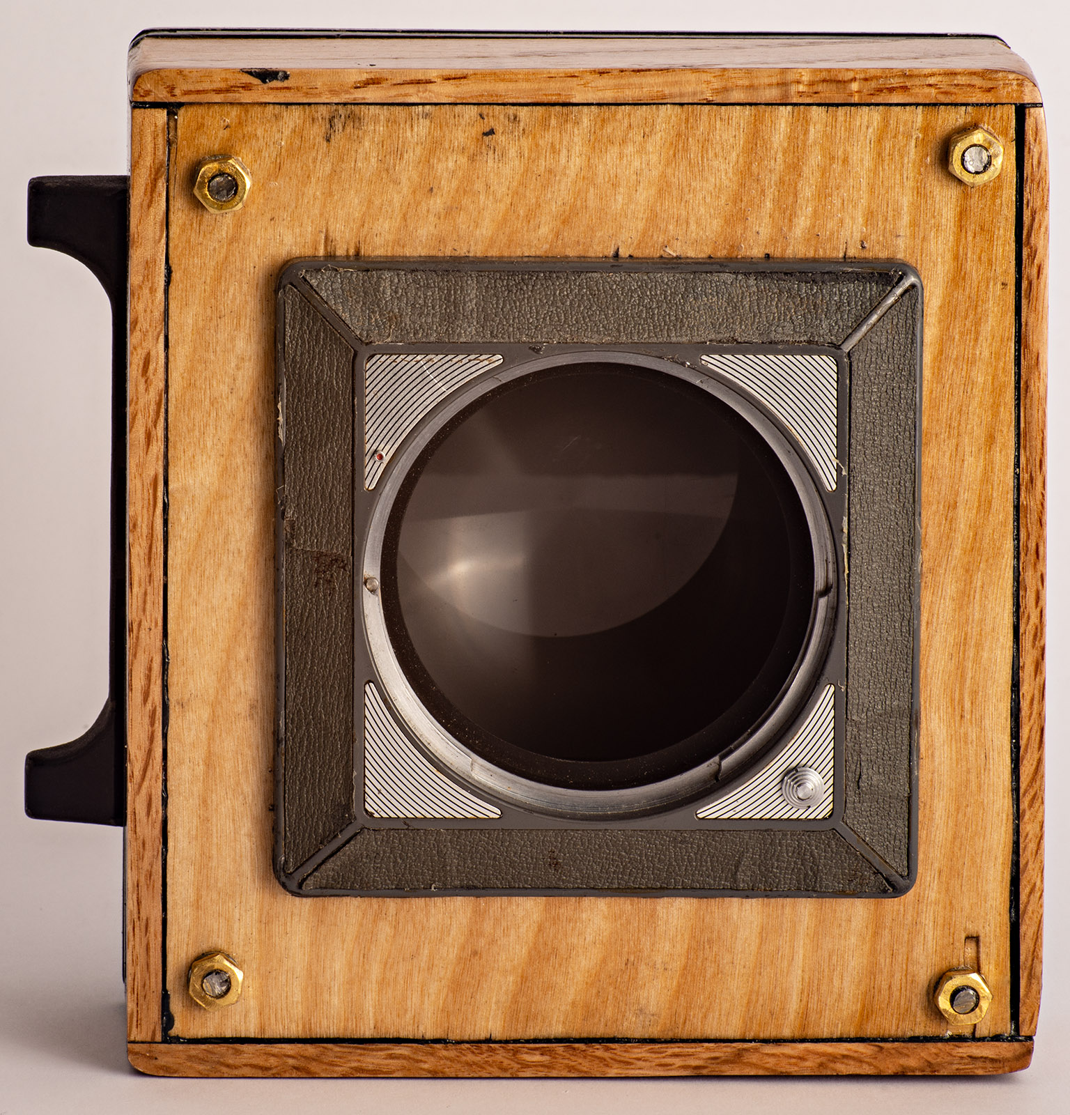

Here's one that I built awhile back. The Nikkor SW 75mm f4.5 easily covers 4x5 with Grafmatic backs, as well as 6x12 with a Horseman back. The helicoid was from a Chinese seller and the back is from a Sinar. I use this one almost as much as my view cameras, and it's resulted in some very nice photos.

Wow! really nice! The fgrp and the viewfinder are nice items! Do you hand hold it a lot?
