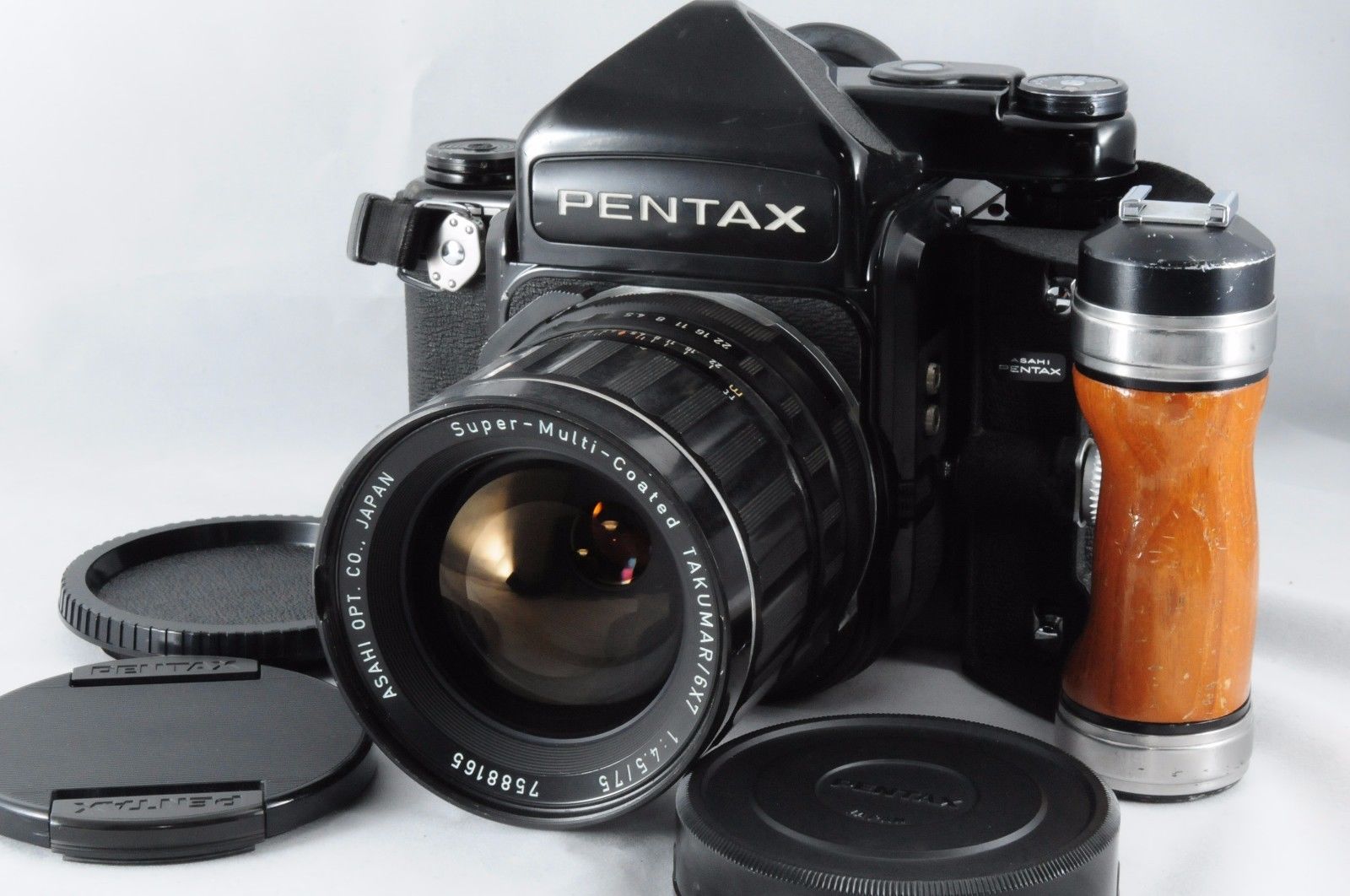

FedEx delivered the prism today and it's a beauty. Had in been in a box you'd be very hard pressed to tell it from a new one...absolutely perfect. Their rating of EX+ was more like LN+. I've found this to be true with other lens/cameras I've ordered from them in the past. I haven't as yet tried it in lieu of the other meter but will soon. The only difference is this was in newer and just has the Pentax logo on the front whereas my other one is "Asahi Pentax".

Well, wouldn't you know it...it won't fit. It looks just like the other one but will not clamp down easily as the other one.

This is not the 67II finder but for the 6x7 or 67. It should have fit. Looks like this...

I have a 6x7 body with an Asahi TTL metering prism. I bought a "Pentax" TTL prism as a spare and it's not fitting. I do not have a 67II body or prism. The only difference between the prism I have and the new one is the nomenclature on the front. One has "Asahi Pentax" and the new one I bought just says "Pentax".

If it is "LN+", you would not be having trouble fitting this prism! My bet is they didn't check the prism at all.
An up-front point: the prism should easily click into place on any of the 6x7 / 67 cameras. The shape/dimensions never changed from the 60s body to the 1990s body. If it doesn't slot in with consummate ease as the prisms are want to do, it's definitely not "LN+"
Mine was described by the seller (an Estate in VT/USA) as mint (as was the whole camera in toto) and remains so 8 years later. My recently acquired fold-down viewer with hood, with the ancient Asahi-Pentax logo, goes freely in and out.
You should ensure the shutter speed pin on the underside of of the TTL finder matches the slot on the shutter speed dial of the camera. Nothing else I can think of other than some form of damage to the mounting pins or (unlikely) some sort of warpage of the prism body. Send it back. :smile:

I think I've discovered the problem. The foam on the underneath side is twice as thick as one the old prism and perhaps is causing this. I looked both prisms over top to bottom and that's the only thing that stands out. I tried pushing the prism on a little harder after finding this but it still won't go.

^Does this sound like someones well intended resealing ( without fully knowing what they're doing ? )
If the foam needs to be compressed on install , then you're probably onto something.

The foam looks good...as new. I've pushed all the around it and it almost snaps locked but not quite. If I could just shave a minute fraction off it it would go.
