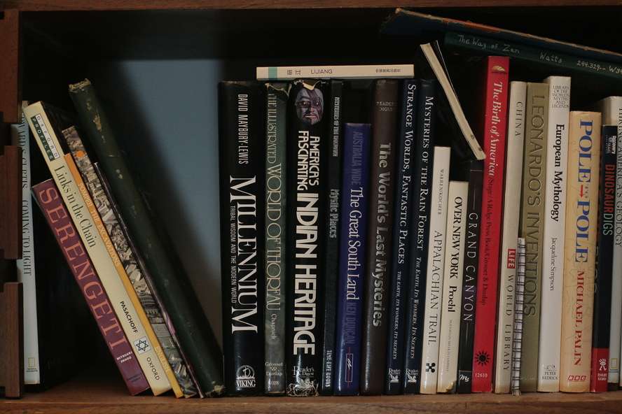

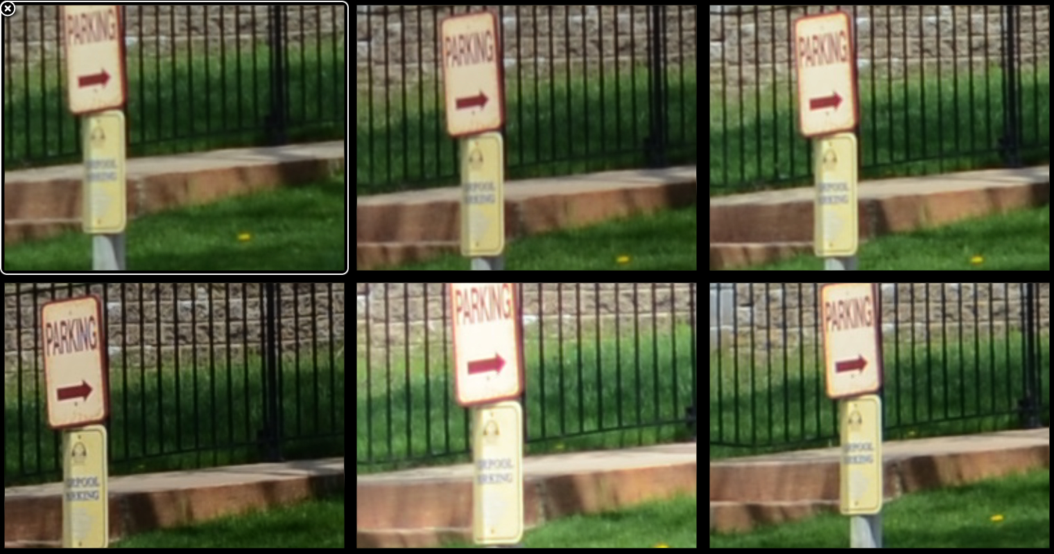

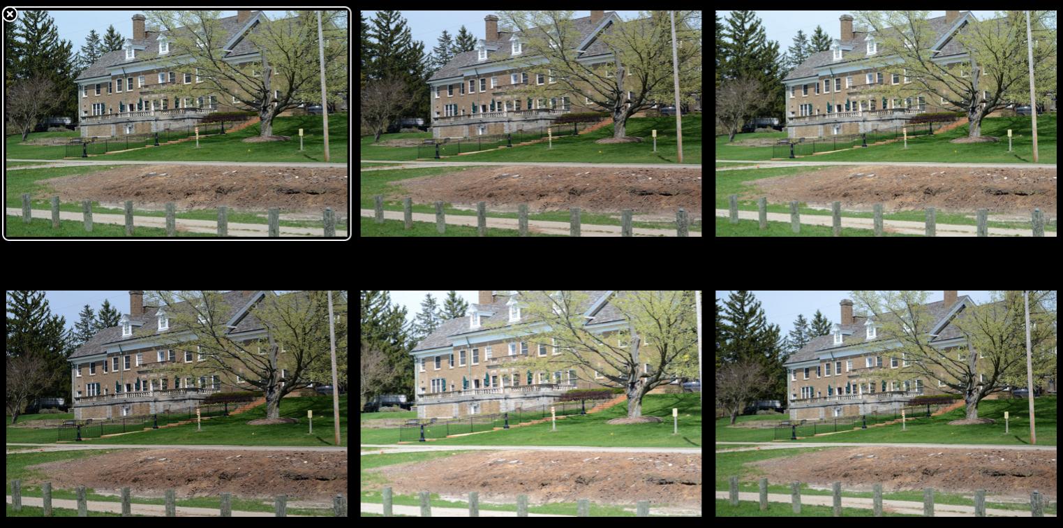

Recently I ran a test session with every normal lens that I could lay my hands on from my own and other's collections. My goal was to see which lenses performed better than others, particularly with regard to sharpness and resolving power. Something unexpected that turned up was an overexposure of every shot made with the 60mm Micro-Nikkor AF D lens. I thought that this was interesting but since I don't own it, I wasn't too concerned about it. My 55 Micro-Nikkor 2.8 AIS will continue to serve me for a long time. Then today I was talking with a friend who told me that he noticed that his 60mm Micro Nikkor AF D gave him similar readings yesterday, that he had not noticed before.
So has anyone else seen such a difference between this lens and others?
The 60mm Micro-Nikkor AF D is the center bottom image in both groups. The image of the sign is a detail of the full image of the house.

I just took some shots with this lens...on my Canon 30D and the exposure was just about spot on ... but I'll take some shots and compare exposures with other 50mm nikkors I have around here (I have a few...) and get back to you...

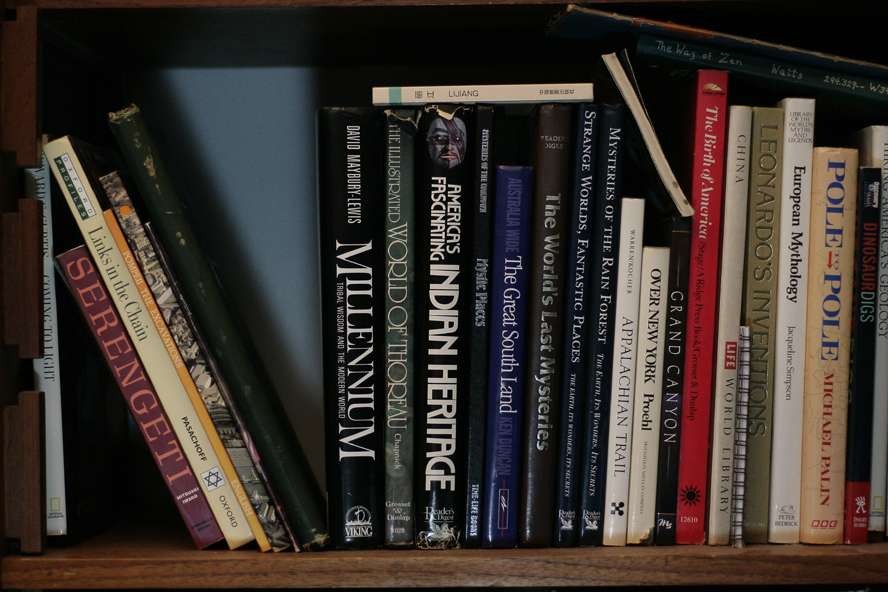

Hiya Kenny....
I took some shots...all on a Canon 30D (sorry they're digital) @ ISO 1000, 1/160 @ 2.8...no adjustments made out of camera.
The exposures are the same as are the results....in terms of exposure...
It does seem that the 50mm lenses are sharper @ the edge when set @ 2.8, and being 1.4 lenses, they are stopped down 2 F-stops from wide open where the Micro was set for the shots...
The 50mm/1.4 Nikkors are nearly identical...the earlier base coated "S" seems to have brighter gray (near 18% gray behind the books), and the multicoated AIS has a (bit) brighter white, and the 50mm Nikkors seem to have a bit more contrast than the Oly50 whose contrast seems more like the Micro-Nikkor....
All shots @ ISO 1000 @ 1/160 @ 2.8...
It should be noted that typically on dSLRs, the more you stop down the aperture the sensor's response is a bit "off" such that the "correct" exposure as viewed on the view-finder's metering scale must be readjusted...and each lens is different, so that's why I shot these as close to wide open as possible....
Hope this helps (and doesn't violate the APUG's analog rules)
It may be easier to see the differences by going here
http://imageshack.us/f/15/6n4p.jpg/
and putting the cursor on the image near the top and clicking on the arrow to go to the next full-size image
Nikkor 60/2.8 Micro
Olympus 50/1.4
Nikkor 50s1.4
Nikkor 50ais1.4
