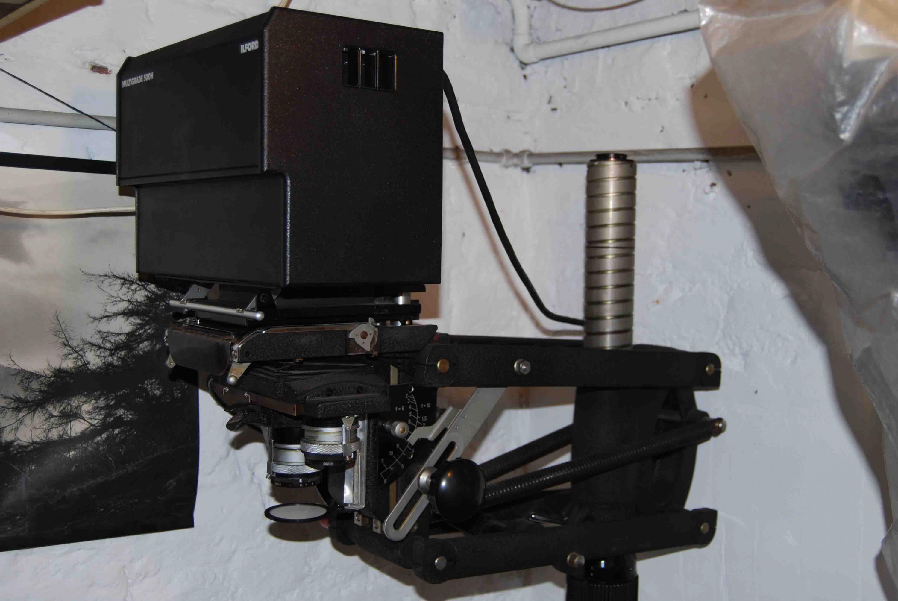

Question for the Experts:
I want to print 16x16 on my Focomat IIc but my 100mm lens will only go to about 12x12. Obviously, if I use my 60mm lens I will be able to go bigger. What are the drawbacks to using the 60mm lens for 6x6?
Thanks!
Unless you have a Wide Angle 60mm lens, you won't cover the format. I'd look for the Rodenstock 60mm f/4 Rodagon-WA Enlarging Lens.
I can't test it because my ceiling isn't high enough, but unless I misunderstand the problem you should be able to get up to 16 x 16 inch prints from 6 x 6 negs with the 100 mm Focotar by winding the head up with the large knurled ring on the column sitting under the head assembly. You will lose autofocus, of course.
Richard
I have just got the brand new first series 80mm Componon lens out of its, pristine box and measured it - It fits the Focomat IIc very easily in either side - However, the mounting thread is 25mm diameter, but comes with a flange, so all that is needed is a metal Leica screw thread body cap with a 25mm hole drilled in it to take the lens
Absolutely simple, but never done as I am waiting to find such a body cap, so the project has remained unfinished for nearly fourty years - Now for that beer!!!
Why I asked for people in the know is because my 60mm lens does cover the full 6x6 negative and it seems to be quite evenly illuminated, too. But I'll do some tests and update.
The Focomat manual and Leica product catalogs I looked at do not indicate if the 60mm is a wide angle or not. So, perhaps it is. Best way to check is with a big enlargement. That will stress the coverage at the corners.
But if it was a wide angle, then I don't see why Leica would have gone through all the trouble to create the IIc as a Two-lens enlarger, one for 35mm and one for medium format.
