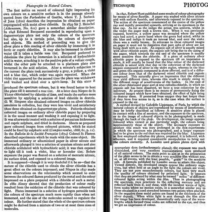

I remembered that in the 1910 Encyclopedia Britannica there is a section about early experiments in trying to get color to record itself. I am attaching a scan (cut and pasted) of it. Just in case someone might find it interesting..
