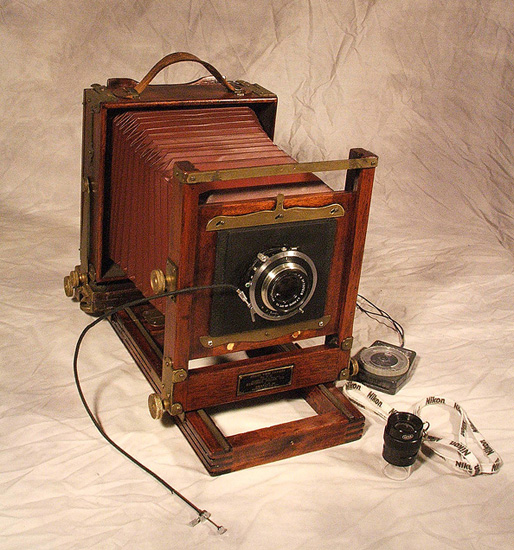

Like Curt, I have a Kodak 2D. Stripped it down and refinished it. Bellows are light tight and it works just fine. Paid $200 for it... fun to use.
Take a look.

Mine looks like this one owned by Gene, I have the extension rail for mine and it and the rail and film holders fit in a California Innovations pop cooler. They are available at Walmart. In fact Walmart is a good place to get cooler type carriers cheap. The 2D is very respectable, I was at the Valley of Fire with it and some people there who saw it made all kinds of nice comments, like "that's a real camera" etc.. I have a Seneca also in 5x7 and 8x10 but the Kodak, even though it is a bit heavier, is very solid and won't let you down. I also have a C1 with an 8x10 and 5x7 back but I don't think I will ever take it out again unless it is setup next to the truck. Even then it's too heavy. Live and learn. It was cheap and I restored it and made it look and work very nice but as a 5x7 it's like a 5x7 field camera with an extra 20 pounds of weights handing on it. I am amazed when I see Brett Weston pick one up attached to a tripod and put over the shoulder and walk it around in the video by Art Wright. It might be a good base for an 8x10 horizontal enlarger project.
