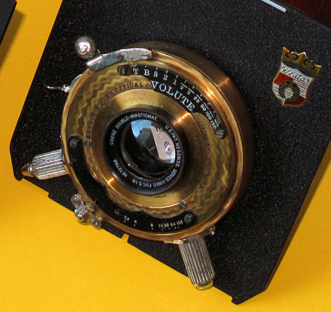

Here's a shot done with an uncoated 5" f:6.8 Goerz Double Anastigmat (pre-1904 Dagor) on 4x5. I like to think the jpeg retains some of "the look".
Oh, and the lens itself is tiny. The glass is about the size of a small thumbnail.
The long side of the format typically makes a pleasing mildly wide focal length, so 5" or 120mm/125mm for 4x5, 7" or 180mm for 5x7.
Cheers, Steve
