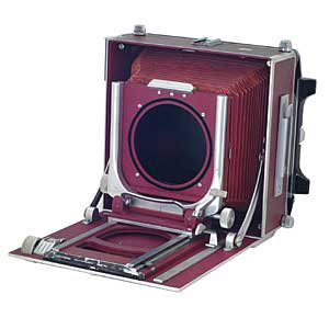

Is this 5x7 Technika a III or IV?
That is the question, is this a III or IV?
Robert N.

With the exception that mine is a Super Tech, that does look very much like mine, i.e a IV.

I have consulted "The Linhof Camera Story" (published by Linhof itself). Your camera has one focusing wheel (at the front edge of the baseboard), which points to Technika III, also the book refers to the luxury version of the III available to special order with red leather covering and bellows. There seem to have been 2 models of the III, 1950 to 1954 and 1954 to 1956. The second of these is described as having an "engagement rack" for the rising front - I no longer have a Technika but I think this was a wheel and spindle which could be pushed sideways to lock this movement. As others have remarked, the development of 5x7 Linhofs was somewhat organic and gradual, with no really dramatic differences between models.

It seems like the one in the picture I posted is probably a III and from what I've understood, the IV doesn't have forward tilt. Sounds like I'd have to get a Tech V in 5x7 inorder to also have forward tilt - and that is out of my price range for sure.

Whichever model this one is, the picture does show the release lever for tilt on the front standard (on the left hand side of the standard, just above the knurled knob (right hand side of the photo)). So it still might be worth considering.

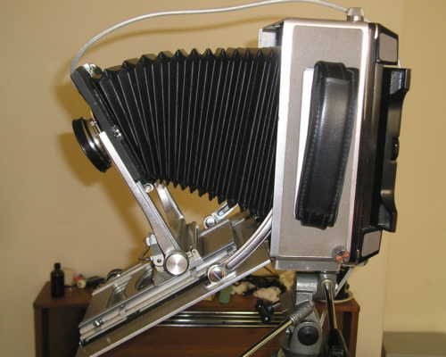

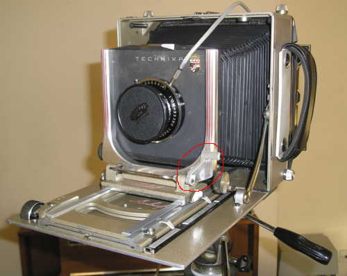

Hah. I finally managed to get hold of one of those digi things, so here are a couple of photos of my Technika. From its serial number this has been identified as a 1960 Mk IV.
One is a front three-quarters, with the front tilt lever circled in red; the other shows forward front tilt achieved using the drop-bed.

Your camera looks very clean - I'm jealous:smile: I also see the tilt lever, wondered what that was for, and the red stripes.
