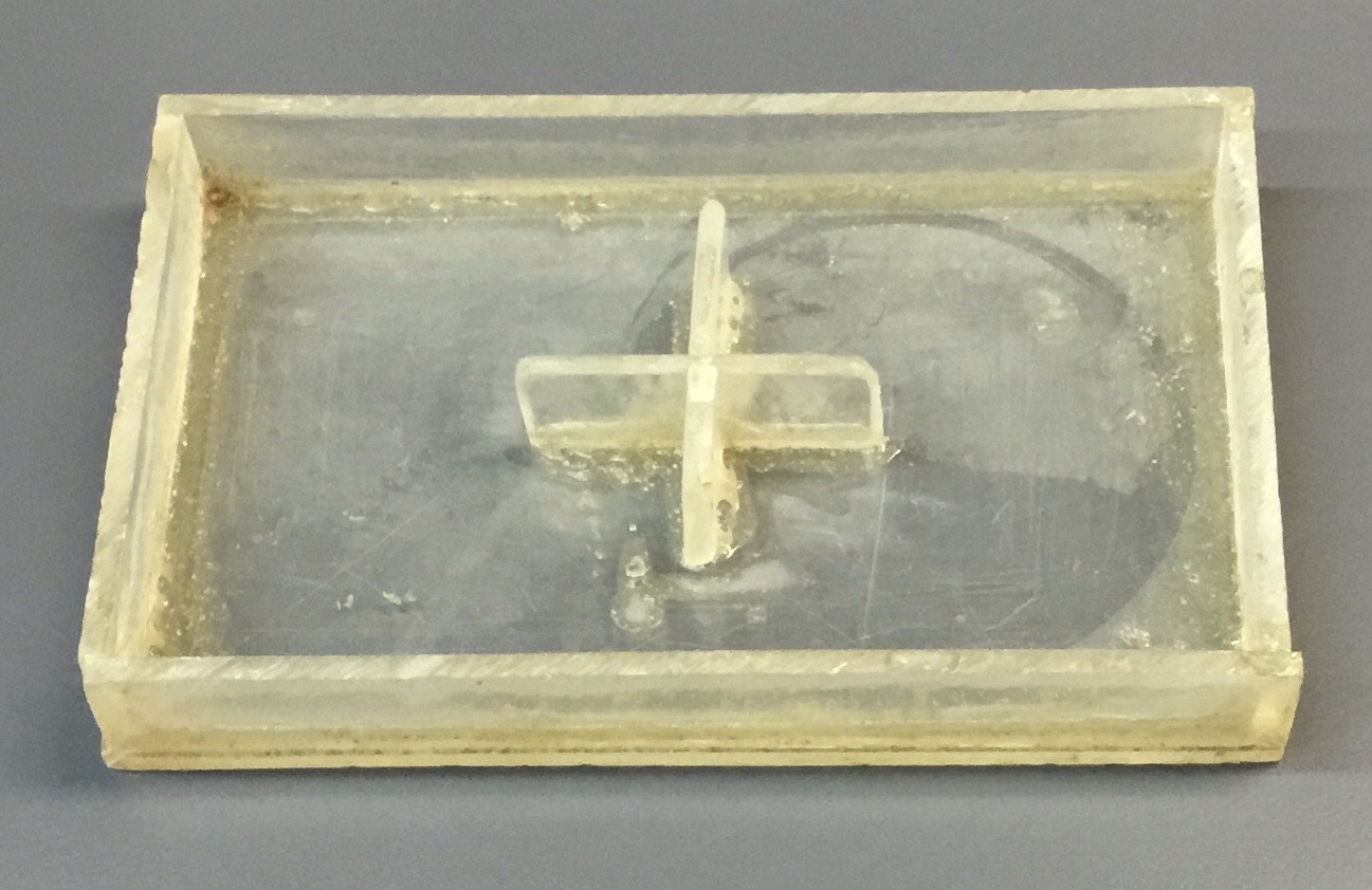

Hey, thought of you, I’m going through some darkroom stuff and one of my tanks has a home made floating lid. It’s plexiglass so it wouldn’t be had to make. Here’s a photo. My other thought would be to us Sintra Board (foamed pvc) which should float so all you would need is a flat piece and some sort of handle.
Hope this helps, otherwise good luck with your search.

You can also use spar varnish or "System 3" epoxy on a light weight Basswood board
, and a round wooden drawer knob, with a stainless steel screw holding it together.
As long as you give it sufficient coatings of varnish or better yet, the epoxy, it'll float without soaking up or polluting your chemistry, but first, slightly round over the top and bottom edges first.
