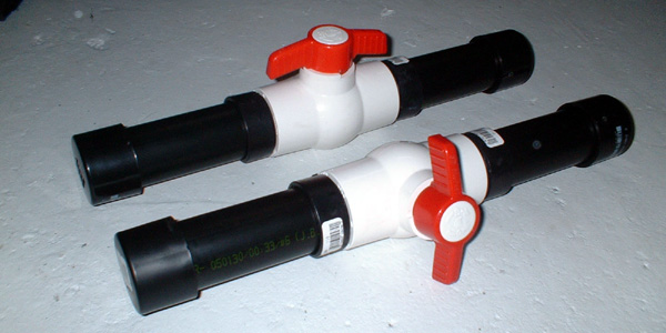

Daylight Film Tubes
I made my own set of BTZS tubes with a bit of a twist. I put a ball valve in between the two tubes so that I would be able to change chemicals in daylight. These were made for 4x5 but they were simple and cheap to make.

Dsve S. do you use a "liner" between the back of the film and the tube or just slip the film in and against the tube wall?

Dave S - that's a cool idea. I may have to try it. I have the same questions about liners and light tight ness, but if it's working for you now I guess it must be light tight. Cool.
I'm a LF newbie, no liner. The film seems to slip in and out without any trouble but I have had some scatches.

Jay/Allen, the tubes are light tight although you have to remember to close the valve and remove the right end when changing chems. I use the tubes like a reel tank, fill to completely cover the sheet film and agitate via inversion. It takes about 200ml per tube to completely cover the film.
