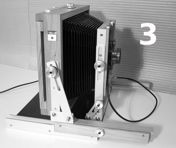

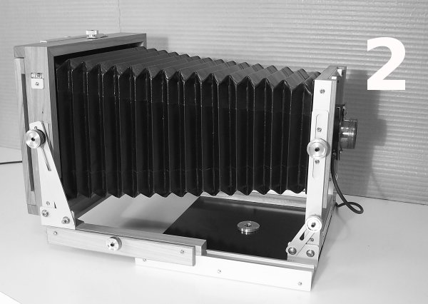

The camera itself is lightweight enough to be used vertically, if I wish to. My Manfrotto 141RC works in a pinch, but a Manfrotto 029 head would easily handle it. A few photos follows here.

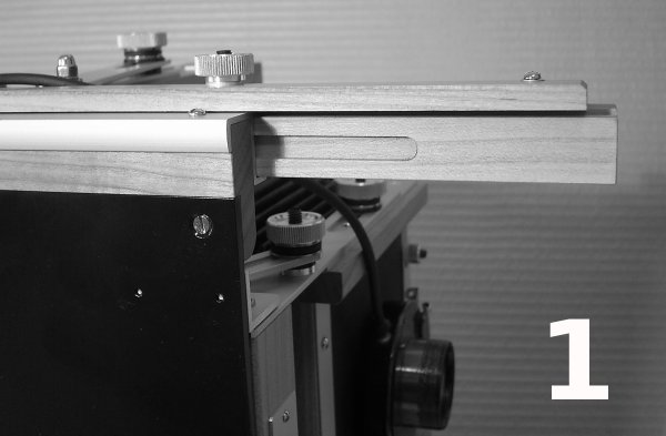

In photo 1 you can see the underside, with the sliding parts.
Photo 2 shows the camera fully extended. As you can see the tripod bushing is rather at the front of the camera, with this extension. It would be possible to make the milled part shown in photo 1 longer, but this would tax the design too much, possibly gaining a few centimeters of extension but making the camera less steady. At this extreme extension, the camera still doesn't move when inserting a filmholder. The camera has back focussing as can be seen in this photo. Anything longer than a 240 mm lens wouldn't be useful, I think. With my Conley 210, I am able to focus to 90 cm at the closest.
Photo 3 shows the shortest extension, where a 120 mm lens (provided it isn't too heavy or big) would be the limit. At the shorter end, it would be possible to get near to 1:1 macro, and a G-Claron 150 would work in the close range, as it would cover with room to spare. The downside to this, would be the limited movements.

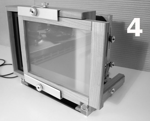

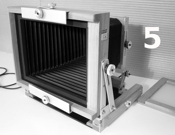

Photo 4 shows the groundglass. There is no marking on the groundglass, but it would be easy to fix that with a pencil on the ground side. Note that it is only possible to insert the film holder from the righthand side. Unscrew the knobs top and bottom, move out the groundglass...
...and it looks like in photo 5. There's always a risk with things you can remove from the camera, but I hope I can get down some routine to put the groundglass somewhere safe. Time will tell if I will go crazy with all this removing and replacing the groundglass... :smile:

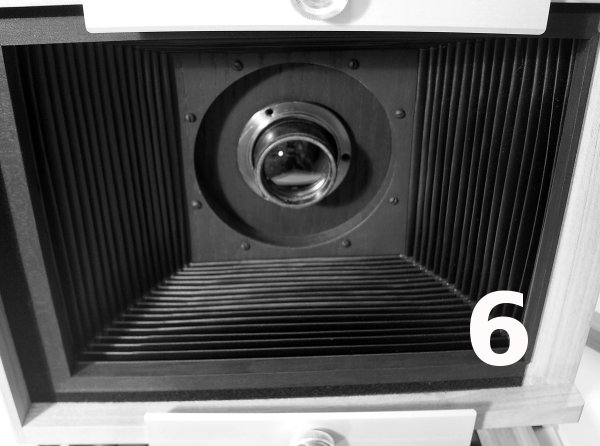

Photo 6 shows how the bellows is secured to the front standard, with the lens (provisionally) in place. The interior of the bellows is some kind of plastic/synthetic material.

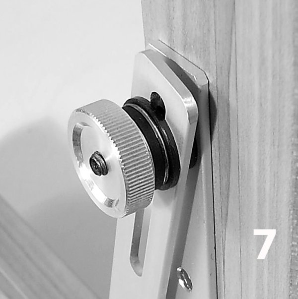

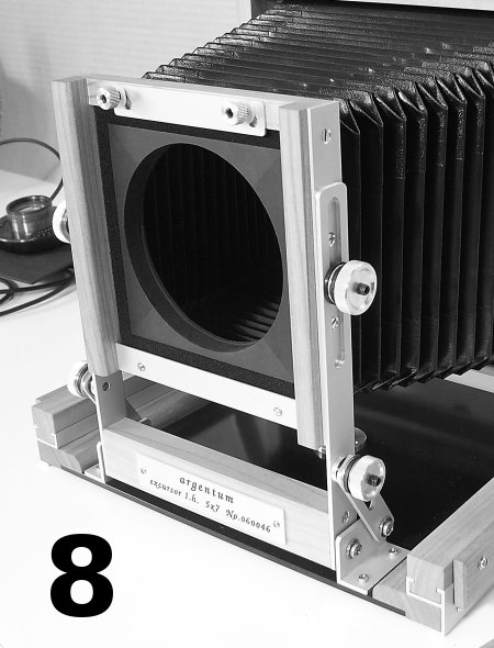

Photo 7 is a detail of one of the knobs and the various washers. It varies from position to position whether the the washers are metal or plastic, or as in this example, both. The knobs themselves gives good grip with bare hands, but may be problematic with gloves on. The knobs fastening the sliders are a bit on the small side, but none of the knobs are placed in hard to reach positions.
The front (photo 8) with the lensboard detached. The lensboards are a bit tight to fit. Note the black felt lining the outer "rim". Also, there is a zero position on the righthand side (looking from the front) but no detents.

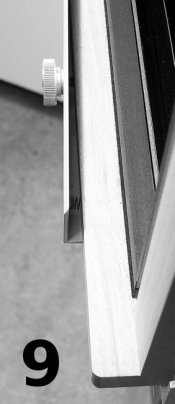

A smaller detail is the spring-loaded part of the back (see mid/bottom part of photo 9). At first I was expecting these profiles to be loose, but eventually I discovered the springs fastened to them, which makes the removal and insertion easier. In the long-term, it remains to be seen how this construction holds up over time.
