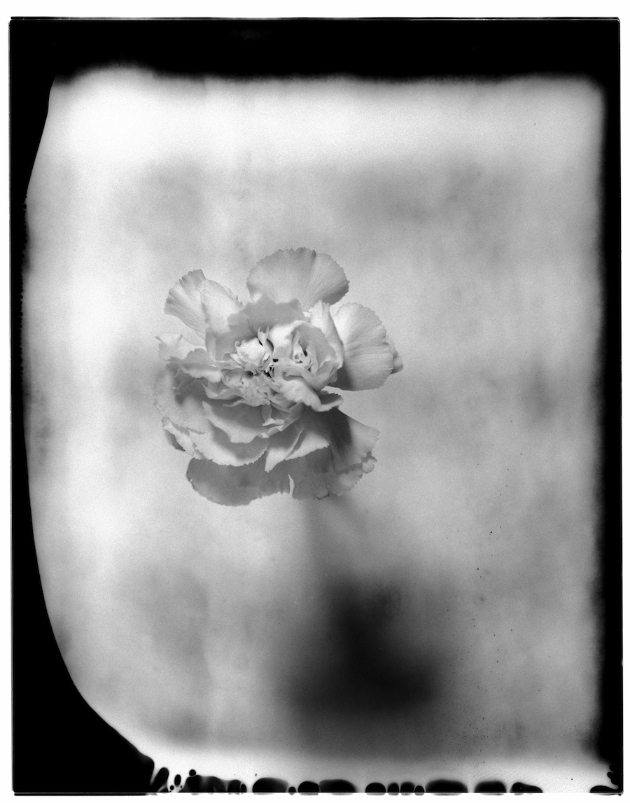

After a "successful experience" with the first three sheets I have run into a series 5 of failures. They are partly my fault in I misloaded one packet which bent the springs in the holder which then lead to 2 more failures before I figured out the springs were bent. "Fixing" the holder as best as I could, I have gotten images on the last two. One was also my fault in misreading my light meter and underexposing the sheet, the last one is posted below. Not sure why the background is mottled - image is of a white carnation on a white background. Developed just over 2 minutes and fixed in Ilford fixer. I have yet to have a positive that I would consider "keeping" - but I am using this film for an instant negative and would have no real use for the positive except as a proof.
Same image posted in gallery - New55 - 210mm f11 1 sec - developed 2+ minutes
Robert, i have used old 55 and don't even know where to begin to comment - but a lot of "feelings" are evoked by your photograph and message. I got into large format starting with PN55. In my gallery is a Stella Doro Lily done on PN55. I love that negative. Your carnation, is just amazing from beginning to end, but maybe not the same effect or process as PN55. What i find so amazing in this the staggering gorgeous tonality, the subtle separation, shadows, highlights. I don't know quite what to say about the background except it is where i feel it belongs. Mostly, the delicate detail just blows me away. The shadow is nice, except i would have cut it out by making a square crop decision - a mistake looking at this. So, what other film choice would have produced the same result? I don't know, i am an amateur that has nowhere near the experience and evidence to decide. What has bothered me with every New55 image that has been put up in the gallery since about December, is the incomplete developing gel spread, forcing one to hope for the best in the center and make sure nothing important is near edges. And, the cost. So i just can't get to a place to play with New55 at the cost per exposure, given my limited budget and limited time to play with cool fun stuff. This image of yours, though, just blows me away and makes me want to make such delicate, beautiful images with New55. I have the holder, and have been despondent over losing the Polaroid, quickload and readyload that was all i ever used, not having film developing facilities set up. Now, i had to replace those holders with a large arsenal of regular sheet film holders, a harrison large tent, and means of developing film in the bathroom. Well, it works, and to be fully honest, has enabled me to make the move into 8x10 finally, which i absolutely love. Well, i don't have a means yet of making prints by enlargement, which is why i wanted to go to 8x10 at all.Love those contact prints! Every New55 image i have seen in the apug gallery has been fantastic and inspiring to me, anyway. Yours here, is beyond adequate description and appreciation.
