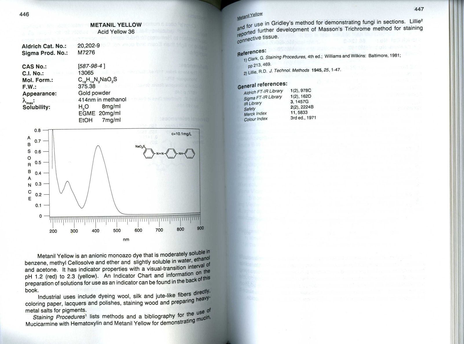

Metanil yellow , sodium salt of M Sulfo Benzene Azo diphenyl amine color index 138
% 1.................30 grams
Glacial acetic acid % 5.............900 cc

Metanil yellow , Sodium salt of m sulfo benzene azo di phenyl azoine
color index 138
.......................22 grams

I'll see if the Sigma-Aldrich book has these dyes listed and post them if so.

I have Metanil yellow and will post shortly. .

Metanil Yellow
This thread is a interesting, and I'm sorry but I missed it initially. You would really enjoy J.S. Friedman's book Umut, he worked for Technicolor (or consulted?) at one time, and discusses the scheme in some detail.
It's amazing to think that Technicolor made literally thousands of dye-transfer prints in a single day, or with a single print of a movie, and with a remarkably high degree of sophistication.
