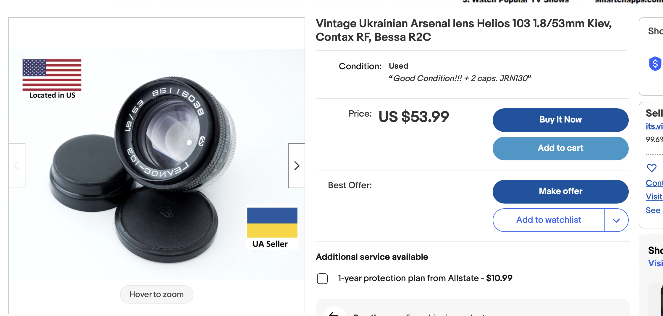

Thanks for the heads up, I'll do some research. Bob.
Update.. Might that lens be called something else? Helios-103 or Helios-81 ? Both are 53mm and I can't find a Helios 53. Thanks, Bob.
This is the Helios 103 (I am not affiliated with the seller - the listing is shown below just as an example for clarification - plenty of these lenses on Ebay for well under $100 USD. Also I have shot copies of this lens on digital, on a Kiev, and on a Contax IIa - all with great success. These lenses can sometimes vary in quality, so you may have to source two or three to find one you really like.
Hope this helps!
Paul
