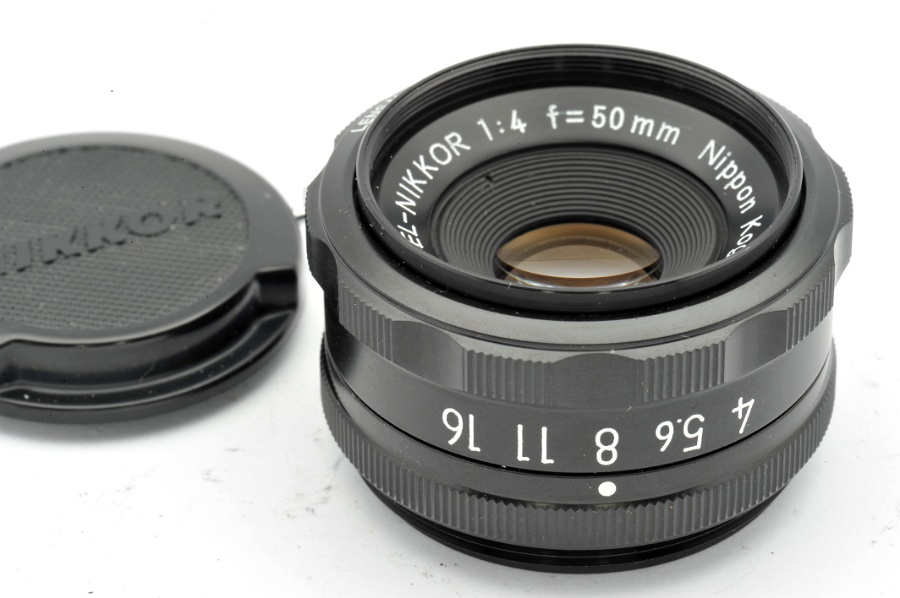

I saw it advertised in a brochure a long while back, I think. Know anything about them? Thanks

It is their "older" standard enlarging lens and more budget in comparison to the newer 50mm f/2.8.
I own both (the f/4 was the first one I bought) and they both perform very well. Now I like the f/2.8 more because of the extra stop (it makes a difference when focusing giving a brighter image) and the convenience of illuminated aperture scale.
Also the f/4 has 4 elements compared to the f/2.8 which has 6 elements. In general 6 elements are considered to perform better than lenses with 4 elements. But in the end it all comes to personal preference. I've heard from a lot of people that like the f/4 version better.

That is all true about the older metal lenses, but I'm asking about the newer "N" version.

Oh, I didn't know there is a newer version. I assume it has the same plastic design as the newer El Nikkors?

As far as I know, the is the old line:
and the newer one:

Chip... you're talking about lenses that are decades old. The El-Nikkor lenses are typically very good, but that tells you nothing about one specific sample. I have El-Nikkors 50mm F/4 that are superb and I recently tested an El-Nikkor 50mm F/2.8 that turned out quite disappointing. I notice you're asking many questions about gear, like...is this good.. what is the best?
Frankly... there is no answer to such questions; you'll need to find out yourself, testing the gear you have, deciding what you like most. Make (many) photo's, spend lots of time in the darkroom, experiment and find out what works best for you.

The 50 f/4N is optimized for 5X prints IIRC. The 50 2.8N is optimized for 8-10X prints. So, for 5X7 prints, choose the f/4. For 8X10 to 12X16 prints, choose the f/2.8. The f/4 does an outstanding job for the smaller print size. What size prints do you prefer?

The f4 50mm is 4 element , 2.8 6 element . I used an f4 for 20 years until I bought a 63mm . They are both excellent lenses . The old metal body version came with a 34.5mm Genuine Nikkor lens cap with chrome buttons :D. The neu version they didn't even give you a real lens cap . Nows the time to buy every enlarger lens you ever dreamed of stuff is going for 10 cents or less on the dollar of original price .
The only other 4 element el nikkor I know of is the 75mm.
