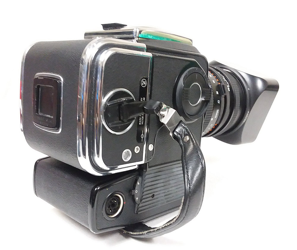

Hello all, this is my first post here so be gentle! I recently inherited some old film cameras and i'm trying to decide if i want to keep them for myself or sell them. I got them from a family friend who recently passed away and i was given them because i'm a pro digital photographer and always wanted to experiment with film. I am 35, never used film cameras really but i have a lot of experience with digital SLR's. Received Hasselblad 500 EL/M, 503cx, 50mm & 80mm planar lens. 3 backs. Leica if.
Sorry i am such a newb, but i'm just trying to wrap my head around how these hasselblad's work.
PROBLEM: 500 EL/M has a 80mm planar lens stuck on and is very loose. For the first few days i couldn't get the 50mm or 80mm lens on the 500 EL/M but i could on the 503cx. I noticed that the screw on the 500 ELM was in a different position than the 503cx. I I couldn't get the lens on for a few days. Somehow this morning i got the lens on and right now its very loose and will not be removed. I have read some things online where i need to remove the camera back and i see a screw that is not too far from the back lens element and i can see this being problematic if i try to screw this while the lens is attached, because of slipping and damage the lens. I read that i can use blue sticky tac and put it against the lens to protect it while i do the screwing but i want to make sure that is my main problem before i go about this.
Also is there a way to tell if my power supply and or batteries work? It came with 2 blue old looking batteries and a charger, i'm guessing these have to be operating in order for the camera to work, correct? How can i test these batteries or know if they are good? can i use any other batteries without an adapter?

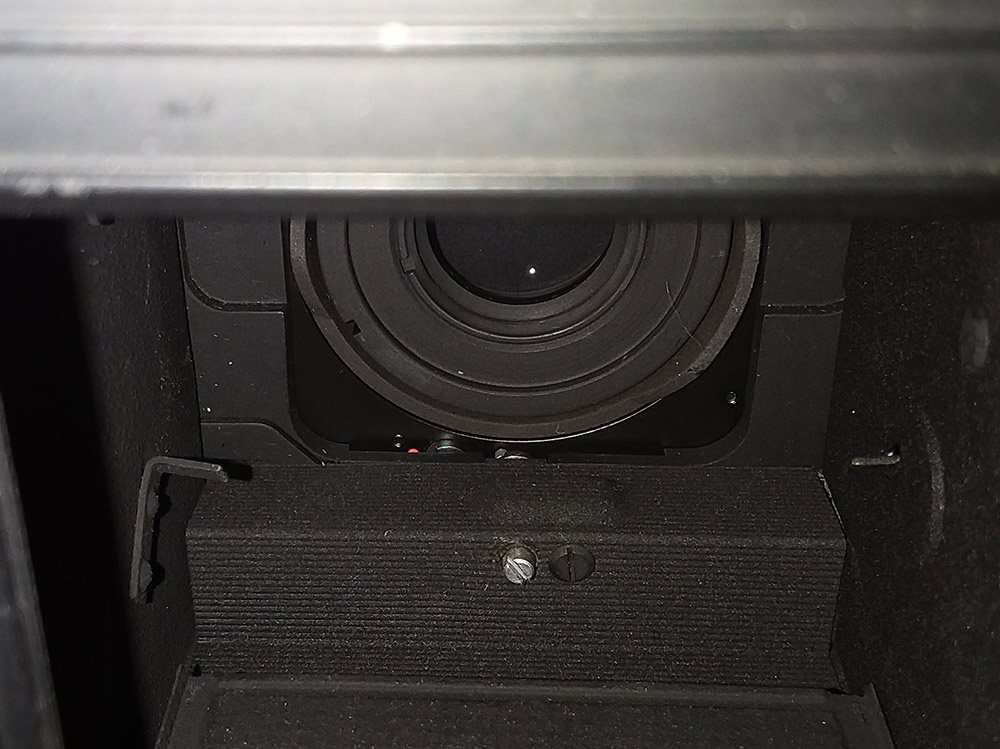

Here are a few pictures to help explain the problem better.

from the pic, it looks like the lens cocking "screw head" in the lens isn't even lined up with the camera internal "screw driver".
seems to me that it's just maybe somehow a very tight fit--maybe a bent bayonet mount. so--us a little force and "untwist" the lens in the opposite direction you put it on an it should come off--standard dismount--it looks like nothing is holding it but bayonet flange friction--maybe just one bayonet leaf and the other 2 are loose--could be your problem all along...give it a good "untwist" impulse and she if she budges around and off it comes.

I was about to mention the same thing. I took a look at my EL and in your photo it looks like the winding key on the lens is well away from the body's coupling. You should be able to twist the lens counter-clockwise (as viewed from the front) while holding the lens release button to remove it.
When the body has power it should cycle, bring the mirror down and it should be good to go for mounting a lens. If the shutter in the lens tripped in all this (the shutter would be closed), turn the coupling in the lens in the direction of the arrow with a coin until it stops. If the shutter is tripped, do not attempt to mount the lens until the shutter is cocked. Pics and a discussion of this are in the manual from Butkus's site or Hasselbladhistorical.eu.
Since you have another body, just work with it until you get the power issues sorted out for the EL.

regarding the tool, as I said earlier, I've never needed one in 20 or so years working with Hasselblads, so, IMHO, you don't need it, and you wouldn't want to use it on an EL body anyway. Beyond that, the magic tool is just a variation of a slotted screwdriver, which will work as well.
Sometimes the shutter in the lens will get released due to handling while the lens is off, in that case, a coin is all that's needed to wind the shutter. The little pin to the right of the winding shaft on the lens is what releases the shutter.
The simple rule is don't ever try to mount a lens that doesn't have the shutter cocked and open, similarly, don't try to mount a lens on a body that isn't wound (mirror down, rear shutters closed). Most manual bodies have an indicator on the right side near the back that shows white if it's wound and red if it's released (mirror up, rear shutters open). If you're using extension tubes, mount the tubes first, then the lens, and remove in the opposite order.
There is a lot of internet lore about the propensity of Hasselblads to jamb, IME, and that of others here, it doesn't happen nearly as often as the internet claims. Yes, it can and does happen, generally it's an infrequent issue if you're careful and follow the instructions in the manual.
What the tool does is allow you to wind the lens's shutter, so that the coupling between the body and the lens is in the correct position to remove the lens.

So for the lens to have the shutter cocked, i need to be able to see through the lens correct? Like right now i can not see through the lens, there is a shutter closed. Thanks again for the info, i am slowly learning how to use these monsters and might be able to take some photos soon!
bdial
Jan 2, 2005
7,516
North East U.S.
Correct, the lens has a more or less conventional leaf shutter, and it must be open for mounting (or removing) the lens.
There is an auxiliary shutter in the body, behind the mirror, but it's only there to keep extraneous light from the film.
You can manually wind the lens shutter using a coin in the slot of the coupling at the rear of the lens, turn it in the direction of the arrow until it locks.
If it won't lock, the lens needs to be serviced.
