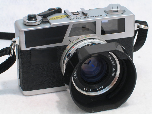

The seller states that the camera is perfect (lens , body, shutter, etc...) except for needing light seal replacements. He wants 50 for it (via craigslist) so I could go purchase it in person. This will be my first rangefinder. I can get a 10 dollar kit from Jon goodman and have a canonet in perfect condition . I've seen prices vary on these. Would this be a good deal?

Yes that is a nice price. Add $10 for the seals and a new leatherette if you want and you are set. :smile:

I just did the light seals on mine and re-touched the black interior with model paint. It was relatively simple to do and turned out fantastic. I used the Goodman seals and the instructions were spot on.
Sounds like a good deal for an excellent RF.

When/if you check the camera, test it on manual shutter speeds and f stops. Many of these will sound as if they're working but the blades aren't actually making an exposure.
It won't work at all on auto without a good battery.

Nota bad deal...
I've paid more for one that needed light seals, so $50 to $60 total isn't bad for an excellent camera.

As for the OP, I picked up my QL17 for $25, with decent seals but with a sticky shutter and inop meter. I sent it out for a $138 (with postage)
CLA and I'm pretty happy with it now. If you can pick yours up for fifty, and all it needs is light seals, Woot!
