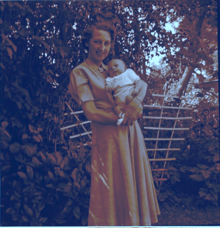

Looking at a bunch of negatives from parents from 1954. They look funny in that there are no sprockets, just a tightly cut negative. The image is 5.75x5.75cm. Kodak Safety Film is the only id on it.
I'm looking for help on two things:
  • What size film is this likely?

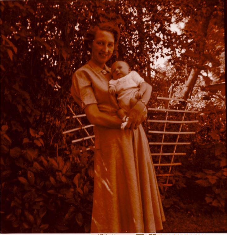

  • When I scan the negative, there is a red hue (see attached screen scrape from Lightroom). It is a B&W but I normally scan in colour. They appear under exposed. I can't really bring them back in Lightroom Classic and when I do, that's when I see the red.
Scanner is an Epson V500. Using standard Epson Scanner software.

Welcome to Photrio.
Can you post a backlit photo pf the negative itself, showing us the entire negative out past the rebate?
It might actually be a colour negative, because there appears to be some colour information their:
AgX

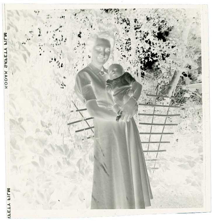

I scanned the negative as a positive and the result is attached. Hope that meets what you were asking for. In terms of the rebate. There is not a lot outside the actual image.

You may have dichroic fog on the negative that is interfering with the scan. Try scanning in monochromatic.

Looks pretty good to me :smile:

I actually meant taking a digital photo of the negative itself with a source of light behind it.
I expect the original result with strong colour cast and narrow dynamic range came from scanning the negative as a colour image. 67 years ago, the film stocks were different enough as to confuse the scanning profiles and the "jiggery pokery" that the scanner and software does whether you want it to or not.

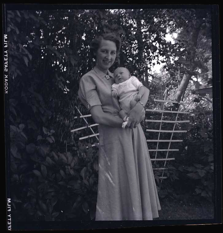

The image area is the 5.75x5.75cm. Actually, I just remeasured it and it is likely 5.8x5.8cm. All the negatives are cut very close to this so I don't know the film size.
Thanks Kino. I scanned it in Greyscale and it came out quite well.

Nice! Dichroic fog usually manifests itself on the negative as a yellow or cyan film on the surface. You can see it if you turn the negative on edge and look almost parallel to the surface; it will reflect with some color. It's hard to see unless you tilt the negative just right and catch the reflection.

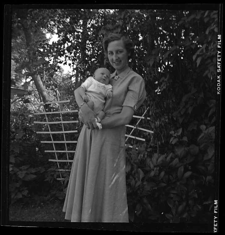

It's interesting that it's supposed to be a square image, but the last (and very good) B&W scan looks decidedly not-square. It's taller than it is long. Maybe just the cropping.
Hi,
images/negatives out of a Rolleiflex Original are higher than wide to compensate parallax effects.
From the Rolleiflex Standard (1933) on they are square. A moving frame in the finder did this compensation then.
Jens

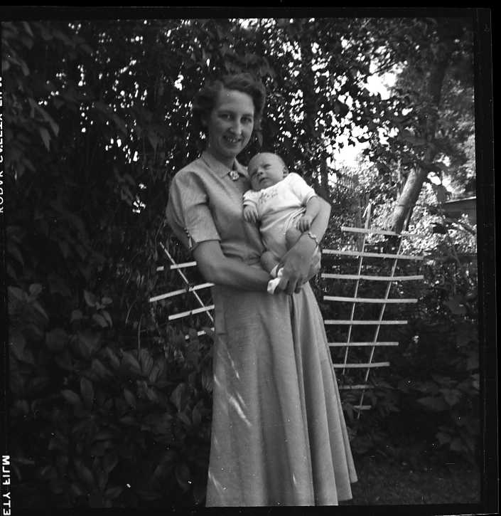

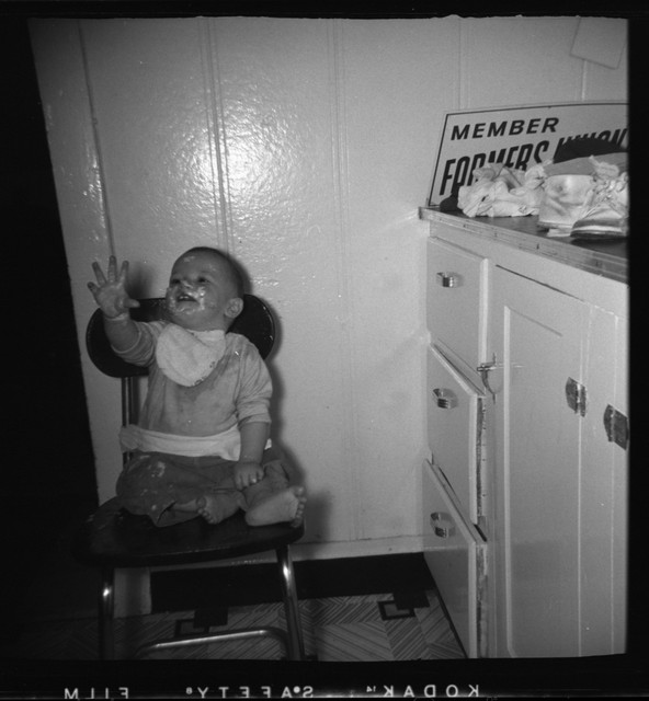

In case you didn't notice, this image is probably flipped. The edge printing is the clue.
Actually, probably not.
Take a closer look, and you'll see that she's wearing a wristwatch, which >90% of people wear on their left wrist.
Also, I've found edge printing in that era to be a bit weird. Take the following two images, as examples.
First is of my grandfather taken in 1952, shortly after he was married; ring and wristwatch on the left hand, and I can assure you he wasn't driving in England. And yet, the edge printing is backwards.
Second is of my uncle taken a few years later in 1955; sign in the upper right shows the image is in the proper orientation, but the edge printing is backwards.
Now, I have other images from around that era where the edge printing is just the opposite. Boggled my mind for a while.
Momus, I had to find a different negative that was dark to confirm the size. I doubt there is a crop on the negative involved.
However, you do raise the possibility that I am looking at more than one film type in this collection I found in a ring box.
