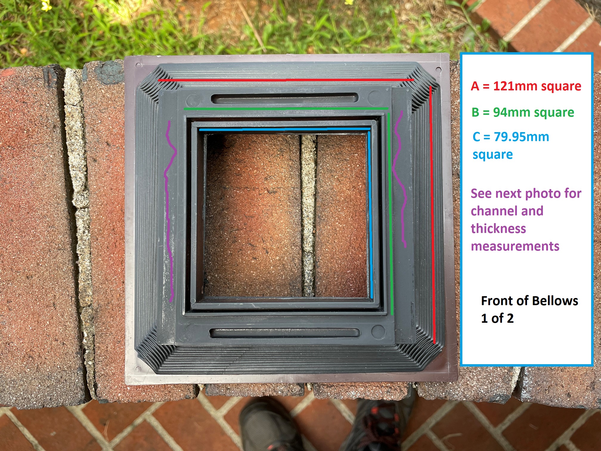

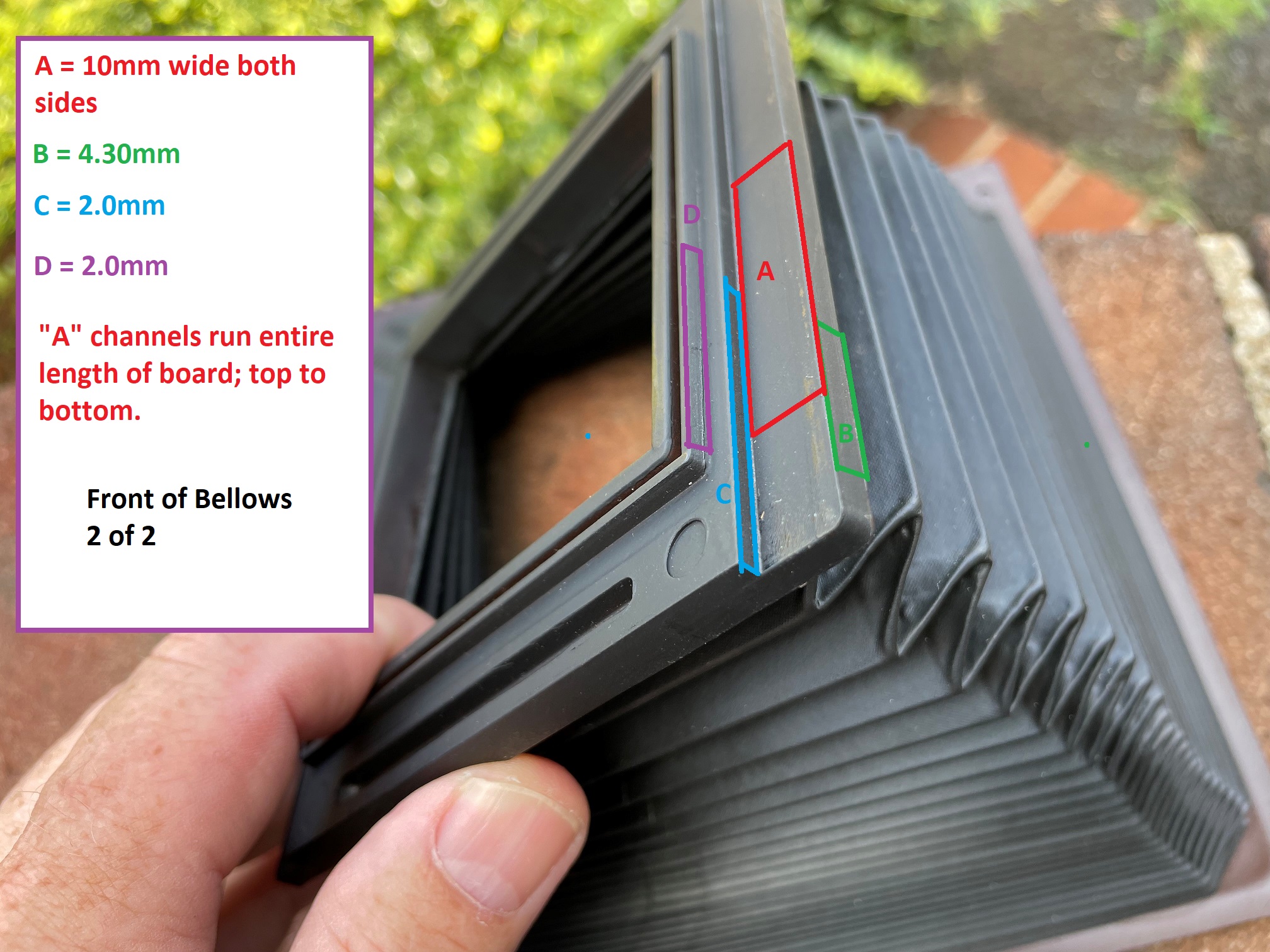

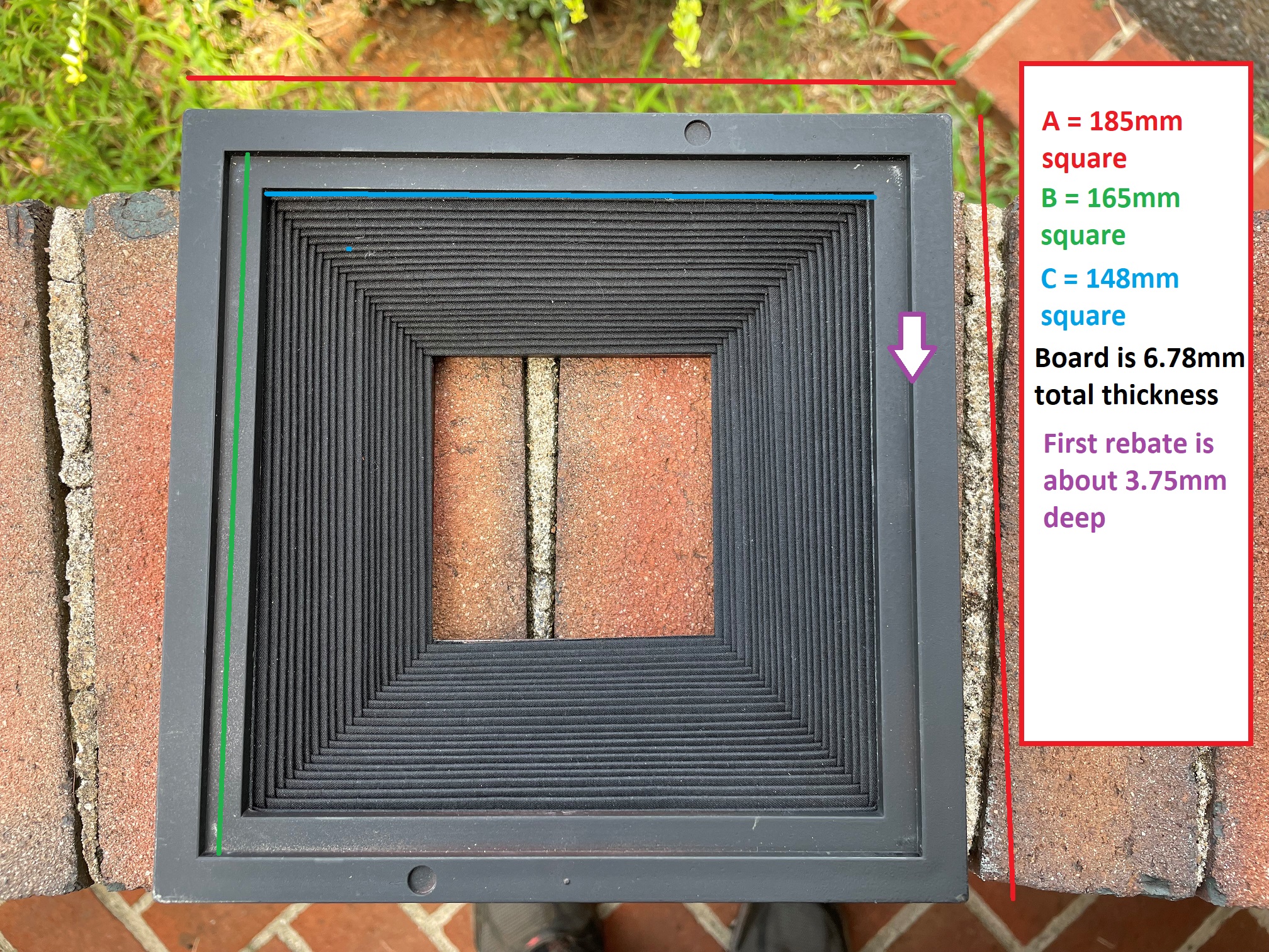

Here are the dimension of the standard bellows frames in case someone else needs these measurements. I have emailed Richard Ritter to see if he can supply or recommend a seller.
