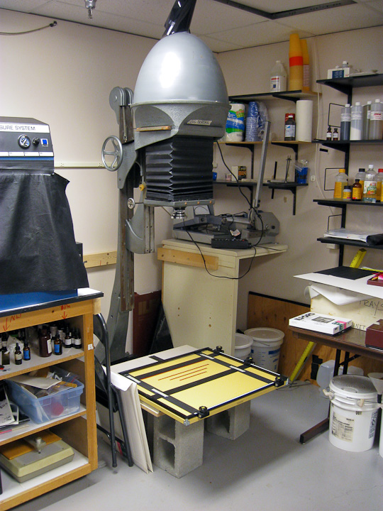

Printed last night on the 8x10. Made 5 prints of one 4x10 negative. I had my JR AP Photo students shoot 8x10 and both contact print and enlarge their 8x10 negatives. They did VDB's for the contact prints.
I asked them yesterday during their critique to give me some thoughts on the 8x10 camera and enlarging the negatives. I have 4 students in that class and 3 of them said that the enlargements were not worth it. We did 20x24's and they look really nice. One of the students said that enlarging the 8x10 negative was worth it. The other three loved the 8x10 contact prints. The one who liked enlarging did not like the 8x10 contact prints, instead she enjoyed 4x5 contact printing better. Their observations were pretty interesting to hear.
Personally I love having that 8x10 enlarger. I drug it out of storage earlier this year and set it up in anticipation for this class. I'm glad I did. Not only for the student's sake, but for my own work as well. I am shooting all kinds of large format cameras and have really enjoyed enlarging both 4x10 and 8x10 negatives. These are some of the best GSP's I've ever made.
Here are some shots of our setup.

Michael, I am intrigued by the responses. Are these young photography students or older folks, like most of us?
Sep 15, 2005
515
Salt Lake Ci
These are high school students in their third year. In the states we call them 'Juniors'. These are kids that are 17 years old. We have a 4 1/3 year long photo program where I teach that is modeled on the traditional university model. A very basic intro darkroom class for one term in 8th grade, a two-year course in 9-10, half is wet darkroom, half is Dig. There is an additional two-year course called AP that our juniors and seniors can take. This is mainly darkroom, large format and alt processes in 11th grade, and they can choose what process and format to pursue for 12th grade. They have a year-long project they shoot during their senior year and submit it for several major competitions at the end of the year. It's quite a program and we have churned out some very talented young photographers. A few have gone on to shoot professionally, but most will just use it to enhance the quality of their lives. The school I teach at is The Waterford School, located in Sandy, Utah, USA. www.waterfordschool.org
