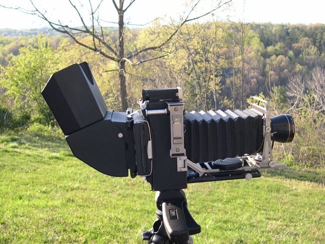

Hi all, did a search but couldn't come up with anything, at least not related to view cameras and a monorail to be specific. I hope to start fooling around with a Cambo 4x5 shortly. I happened upon something on the Web that 'appeared' to be some sort of right-angle view finder for a Cambo. It looked like it attached to the back, but I don't know if using something like this is worthwhile, and does it view the ground glass or replace the ground glass? Opinions and explanations welcome.

There are various monocular viewers, most use the GG. I have a 6x9 one for my horseman that replaces the GG.
I nabbed a binocular viewer from a polaroid MP camera and fitted it to the 4x5 GG of my crown graphic. Heavy but kinda fun.

Thanks. Yes, I guess 'monocular' is the term for the one I saw. I've seen the binocular version for the Cambo, but thought it a bit pricey since I'm just getting my feet wet. I will be trying the dark cloth of course, but I have a bit of gadgeteer streak in me as well. Any thoughts on whether the monocular version would work?

I think the monocular viewers are fine- you see just about everything that you need to see. For really critical focus, I feel that I am better off with a loupe. A viewer does allow me to work more quickly, but impatience is seldom rewarded, in LF.
If you need a quick-focusing 4x5 system for the field and aren't too worried about precise framing, then an RF-coupled thing like a crown graphic will make you happy.
I have no real use for my viewer gadget, to be honest.

I have a right angle viewer for my Linhof. I use it all the time in preference to a dark cloth. Mine has a 2X lens in it. It is supposed to be used in conjuction with a fresnel screen otherwise seeing what is happening in the corners is difficult in anything but the brightest conditions. The cambo right angle viewer is reputed to be very good and compact for carrying.

There is something to be said for the inverted & reversed image when it comes to composition as it forces you to think about it, but on the other hand there is a lot to be said for not having to stick your head under a hot sweaty darkcloth in summer, or fogging the glass with your breath in winter...
I generally use a monocular viewer (plastic - bulky but weighs very little) to compose and then check sharpness in the corners etc with a loupe. A Fresnel becomes essential when using the viewer with my 90mm (very useful even without the viewer of course). With the viewer the image is still left/right reversed.

The light you see on a ground glass passes through in similar direction from where it came from. So to be able to see any part of the GG optimally you need to position your eye so that it is looking toward the rear element of the lens. That is why the centre of GG looks brighter than the edges and corners when you are looking straight at the middle. If from the same position you look toward a corner, it looks much darker and difficult to see.
A fresnel lens redirects the light passing through the GG toward a central position so that from that point the whole screen has similar brightness.
The fresnel lens has a fixed focal length and is therefore ideally suited to only one focal length objective lens. Change to a long focal length lens and it won't work as well. Infact it is wide angle lenses which benefit most from using a fresnel. It can be tricky focussing with a loupe when you are using a fresnel. But with a right angle viewer which only has one fixed and central viewing point, it helps. Some like them. Others don't.

I use an angled finder (Horseman) with my 6x9cm view camera. Bulky but the increase in magnification does help on the small screen. I don't bother on the 5x4 prefering the inverted image, which I find helps with composition, I seem more aware of design aspects. Picture elements seem to be more obvious within the frame when looking at them upside down.

Bob, I have recently invested in an Ebony Wide Angle Fresnel - and its some of the best money I have spent.
I would recommend them to anyone
I can now easily see the image on the GG without the Darkcloth and with a Darkcloth it is realy realy bright
I find it helps when I check the GG composition - particularly in the corners
The Wide Angle Fresnel works on lens lenghts upto 150mm
I have an Ebony camera but it should fit OK with any other camera too - it goes your side of the ground glass, with the Fresnel lens on your side too.
You then need a Protective Glass to protect the Fresnel.

I found my way back to this post. I've acquired a Fresnel screen for my 4x5 and just want to make sure I understand this correctly, that is the order and facing of each.
1) Ground glass with the ground surface facing the lens.
2) On top of this, the Fresnel lens with the circular pattern facing the rear.
3) A protective cover for the Fresnel lens.
Seems to make for a fairly thick sandwich, but it should all fit under the retaining clips on the back..I hope.
Just looking for some verification, aka Newbie assurance.

It depends, but normally you want the groundglass in its original position, fresnel with the circular pattern facing the lens, and you may or may not use a protective cover or grid overlay over that. The main thing is that you don't change the location of the groundglass surface when you put in the fresnel, or it won't be at the film plane.
There are a few backs designed to have the fresnel between the lens and the groundglass, as on some Graflex/Graphic cameras.
I wondered about that as I was putting it in the first time, Fesnel first (facing rear though), then ground glass. I wasn't sure how critical that diff. to the film plane would be. Now I know it is critical. All very confusing to this newbie. I thought one of the advantages to the Fresnel was to straighten/redirect light to the ground glass which is hard to understand how it will if mounted behind the GG.:confused: Even mounted incorrectly, the view was certainly brighter into the corners and out to the edges. I guess that's why folks like them.:wink:

I use the Ebony fresnel, it's behind the GG, the frosted side of the GG facing and nearest the lens. On top of the fresnal I have my grid glass protector. The fresnel spreds the light more evenly once its transmitted through the GG making it much easier to see into the very corners of images projected by very WA lenses such as the 47XL.
To summarise:
1) GG nearest lens, frosted surface facing lens.
2) Fresnel
3) Glass protector/grid.
Behind the ground glass it works the same way: directing the light towards your eye instead of off at an angle. Directing the light either before or after it strikes the ground surface gives essentially the same result. Putting it between the lens and the gg does afford the plastic Fresnel physical protection, but some have cover-glasses as mentioned above to do that job when mounted outside.
