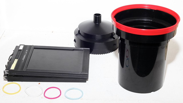

Setup for loading
http://www.flickr.com/photos/digi-film/sets/72157627864733730/
The key is that the "pointed" edge where the film ends come together should abut the outer edge of the tank, otherwise when you put the lid on it can sometimes cause one of the edges to fold over.

The taco method works for me. :smile:
Setup for loading
Thanks for the Flickr link Tony. I usually process one sheet at a time in a Paterson tank, with the film curved around the inner wall. I started to try taco once but I could feel the funnel pushing on the top edge of the film and was worried it might damage it so I abandoned that attempt. I can see that your way of positioning the film should avoid that problem. You can't beat a clear photo tutorial. I'll give this a try next time I have a few sheets to process.
