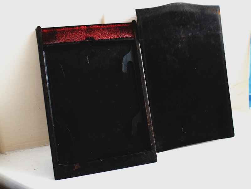

Is this a film sheath, Ian?

aha ,, ok thanks both
