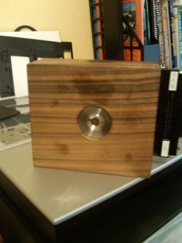

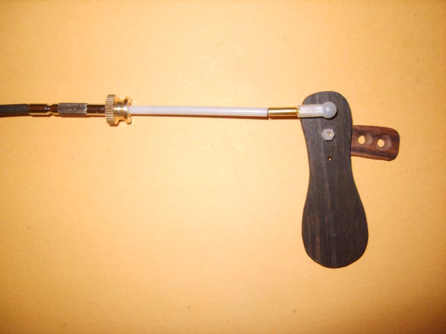

I made a 4x5 pinhole camera some years back... I used a simple wooden paddle as the shutter, but it could use a regular cable release.. It was based around the Skink pinhole fitting and the Skink tripod socket. The shutter is internal and just moves in front of the pinhole from behind.

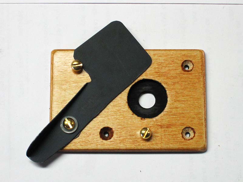

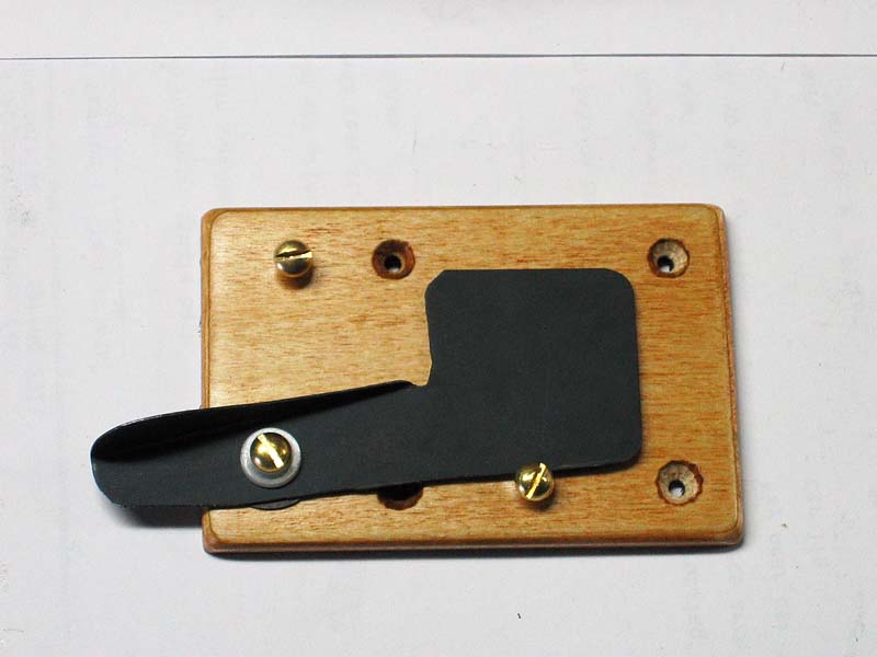

What I've now done twice is a sort of external version of Andrew's shutter. I didn't bother with the cable release as the pivot for mine is set to provide enough friction to hold the shutter wherever it's positioned -- sort of always on "B."
Attached is the most recent incarnation - a separate shutter sub-assembly.
(More than you wanted to see of this WPPD 2011 project here. Awaiting some graded RC paper for further testing.)
