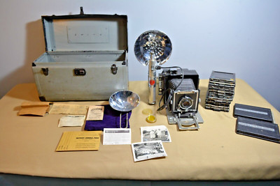

While I do like monorails and may even get one further down the line, I'd prefer something portable that I can carry in a backpack. Although I must admit that the B&J 4x5 Saturn is very tempting. Surprised no one has purchased it yet.
