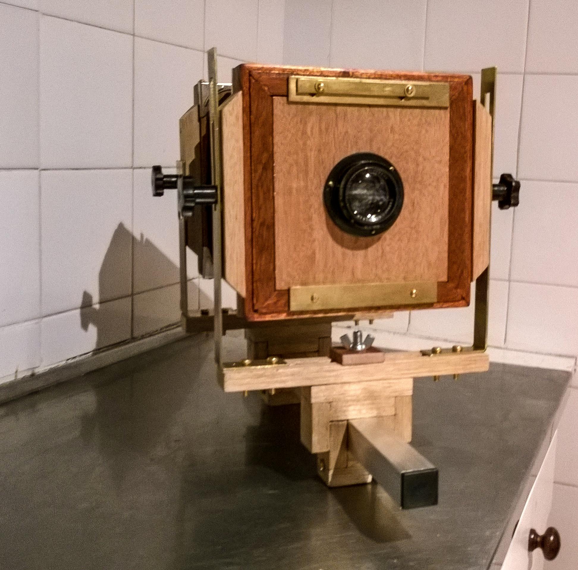

You did a great job, especially on those bellows! The only mod I would suggest is to put some flat washers, or better yet, 4 drilled plates, on the bottom where those 8 bolts hold the front and back standards on.

@Dan, I've been using a lens cap as a shutter. Works just fine with the Arista Ortho Litho 2.0 (ISO 6) I shot on. I'm on the lookout for a shutter though and I may just build a basic one.
@ozphoto, Thanks, this was my very first woodworking project and I say look into a build. It's a learning curve but doable.
@momus, That's a really good suggestion, pretty sure that it will square off everything nicely and make it all more stable. Those bellows took me three days to make.
