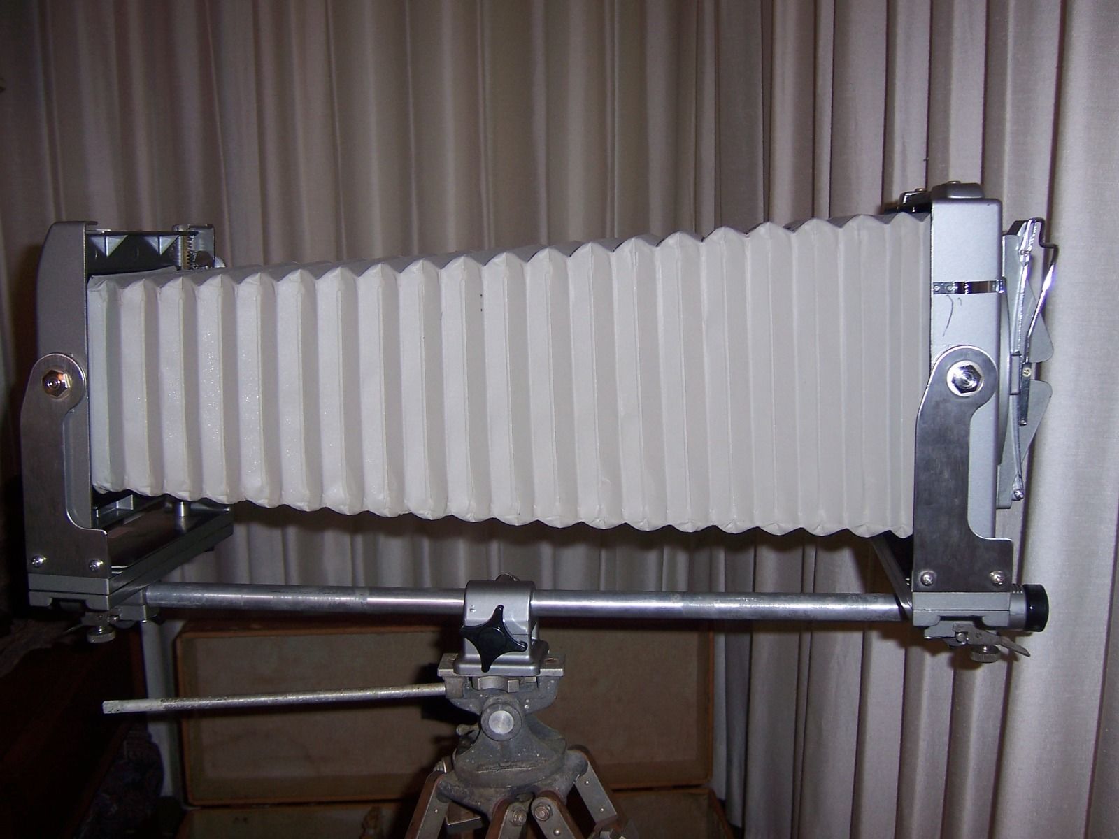

Find a 150 Symmar Convertible and buy/make a lensboard.
its really sad, because my income is strictly limited as my uncle Sam has garnished my wages, however, the sad thing is, I Want this!:crazy: 4X5 NEGATIVES:devil:
aRolleiBrujo
aRolleiBrujo
Apr 23, 2013
798
Modesto Ca
Is this the same thing?
[h=1]Copal No.1 Shutter & Schneider Symmar 150mm f/5.6 Lens[/h]
aRolleiBrujo
aRolleiBrujo
Apr 23, 2013
798
Modesto Ca
Buy it and wait till till you can get a lens. Rome wasn't built in a day. It's a fine camera. Not the perfect field camera, but perfectly usable for that purpose anyway. Made like a tank and does anything you'd need a view camera to do. I've had my Calumet 36 years. Still solid as a rock. As far as the other... don't get me started.
So, How would I go about finding the lensboard, eBay, because I cannot build water! Is there a Polaroid instant film 4X5 back available for these?:tongue: I am so near selling my Nikon F100 now!!!:blink:
aRolleiBrujo
aRolleiBrujo
Apr 23, 2013
798
Modesto Ca
MattKing
Apr 24, 2005
52,906
Delta, BC Canada
Have you priced 4x5 film? Particularly colour film?
Do you have an enlarger (or failing that, a scanner) that can handle 4x5 film?
Have you a meter, a dark cloth, a developing tank for 4x5?
Have you experience with 4x5?
An F100 is a lot cheaper to use, and when used well, will give tremendous results!
aRolleiBrujo
aRolleiBrujo
Apr 23, 2013
798
Modesto Ca
Matt, I have an Epson V500 Photo Pro alone. I see that the 4X5's are around $30, so, I would basically shoot sparingly, but, with gusto! I think the tanks are a bit expensive, so this would be a lengthy process, however, I have longed to hold my very own 4X5 and eventually 8X10 gargantuan negative! I sound as if I have been hit by the Confundus Charm asking about prices, however, I understand that these camera's can be had for song these day's, however, I can't sing well. but, money does!
MattKing
Apr 24, 2005
52,906
Delta, BC Canada
That scanner will not scan any film larger than 35mm.
aRolleiBrujo
aRolleiBrujo
Apr 23, 2013
798
Modesto Ca
Not so, I have scanned my 120 as well! It has a removable top portion to fit the tray.
MattKing
Apr 24, 2005
52,906
Delta, BC Canada
Sorry, you are right about 120.
But it has no 4x5 scanning capacity. The negative scanning light source in the cover is too small.
alanrockwood
Oct 11, 2006
2,185
Several Calumets have recently sold on ebay for around $100, including lens. Shipping typically runs about $30.
alanrockwood
Oct 11, 2006
2,185
By the way, if you can have the tripod included the deal becomes much more favorable.
alanrockwood
Oct 11, 2006
2,185
An additional note. I mentioned that some have sold on ebay for $100, with lens, shipping extra. It is also possible to pay more.
aRolleiBrujo
aRolleiBrujo
Apr 23, 2013
798
Modesto Ca
Thanks everyone, I appreciate the kind words of experience! I am not too good at accepting great advice, so, I most likely will photograph my self in the foot! :w00t::crazy:
fotch
Mar 16, 2005
4,774
SE WI- USA
The Calumet 4X5 Monorail is a great studio camera, well made, worth every penny in what looks like excellent condition. Would not recommend that camera for out of the studio use however. Good luck.
Rick A
Mar 31, 2009
9,925
Laurel Highlands
8x10 Format
My first 4x5 was a CC-401(long rail) and I took it everywhere, it didn't just sit in the studio. Granted, it was a PITA to pack around, but I was determined to use it for anything and everything.
paul_c5x4
Apr 22, 2009
1,942
Ye Olde England
Once you have sourced a lens & board, you will also need film holders.
You may be better off waiting for a functioning kit to turn up in the price range you are willing to pay.
5x4 negatives are indeed wonderful things to hold, but it is not cheap, and then the hankering for something even bigger kicks in.
bdial
Jan 2, 2005
7,466
North East U.S.
It's a great starter view camera. It does everything the "better" and more expensive cameras do at the cost of a little convenience. For money vs. value it's hard to do better. Like Rick, I've hiked around with them, it's a little challenging, but no worse, really, than carting something like an RB with a lens kit around, you're probably dealing with the same sort of weight.
For doing 4x5 cheaply, you can process in trays and contact print with very little in equipment.
Serviceable lensboards can be made with matt board or foam core and an X-Acto knife, or thin modeling plywood and the same X-Acto or a utility knife. Or they aren't expensive to buy, probably 10 or 15 from KEH and perhaps ebay.
For cheap, the lens possibilities are enormous.
Rick A
Mar 31, 2009
9,925
Laurel Highlands
8x10 Format
If you do buy one, make sure you have a sturdy enough tripod to handle it. They are a bit heavy, and the bellows act like sails in a breeze. A Tiltall is a great pod to use.
Bill Burk
Feb 9, 2010
9,308
Haa yes, photograph yourself in the foot...
aRolleiBrujo,
I would not trade-in my experience with a studio 4x5 camera, even though I rather would have had a field camera or press camera to start with. For the low cost, you cannot go wrong.
But if you plan to walk about with the camera and take casual shots, it would be difficult. I am a backpacker, and I would take it but I would ask "why carry 15 pounds of camera". It can be done but it was not practical - I have carried a similar camera into the mountains. So I'd recommend you talk through ideas you have for using the camera.
pbromaghin
Sep 30, 2010
3,807
Castle Rock, CO
This purchase is not a good idea. You have an extremely acute case of GAS accompanied by camera fever. I bought a 4x5 2 years ago after 4 years of research, and even then was not prepared for how different and more difficult it is than 35mm and MF. Nearly none of my existing darkroom and computer equipment can be used with it and still haven't accumulated all the right stuff.
But way more important, you want this thing so bad you can taste it while you have the KGB/Gestapo/IRS on your back. I strongly advise that you get them out of your life before doing anything like this.
