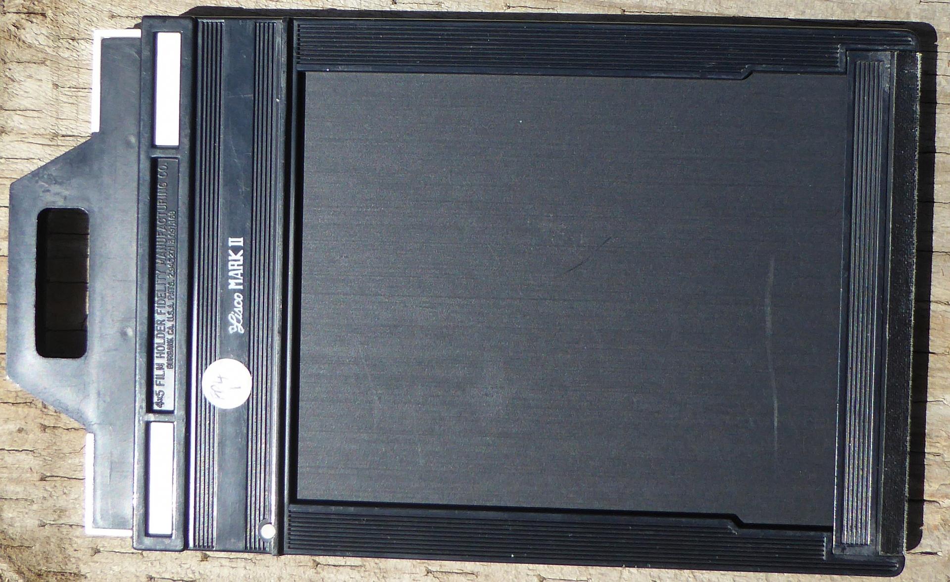

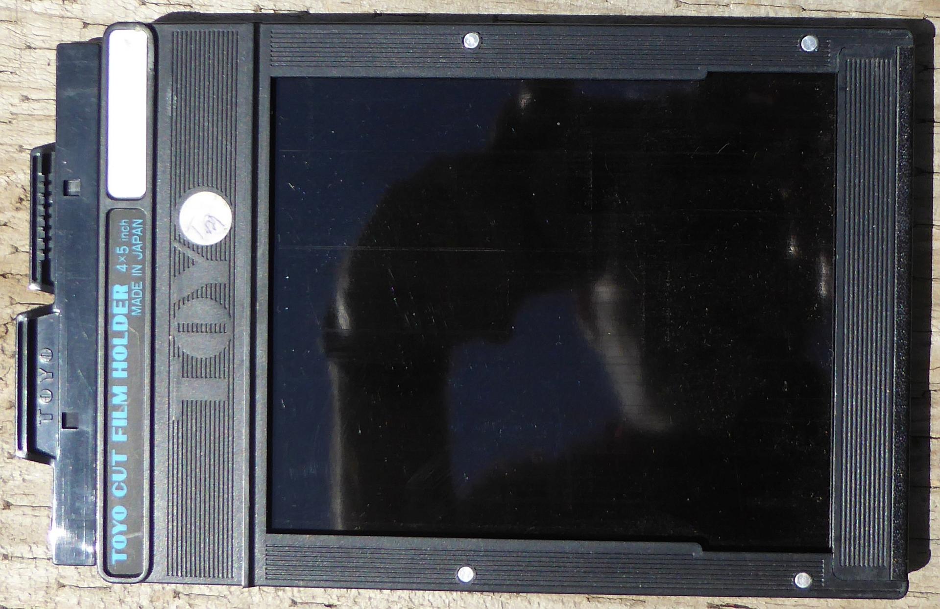

The best and nicest I have to work with are a couple of Toyo units, one is pictured.

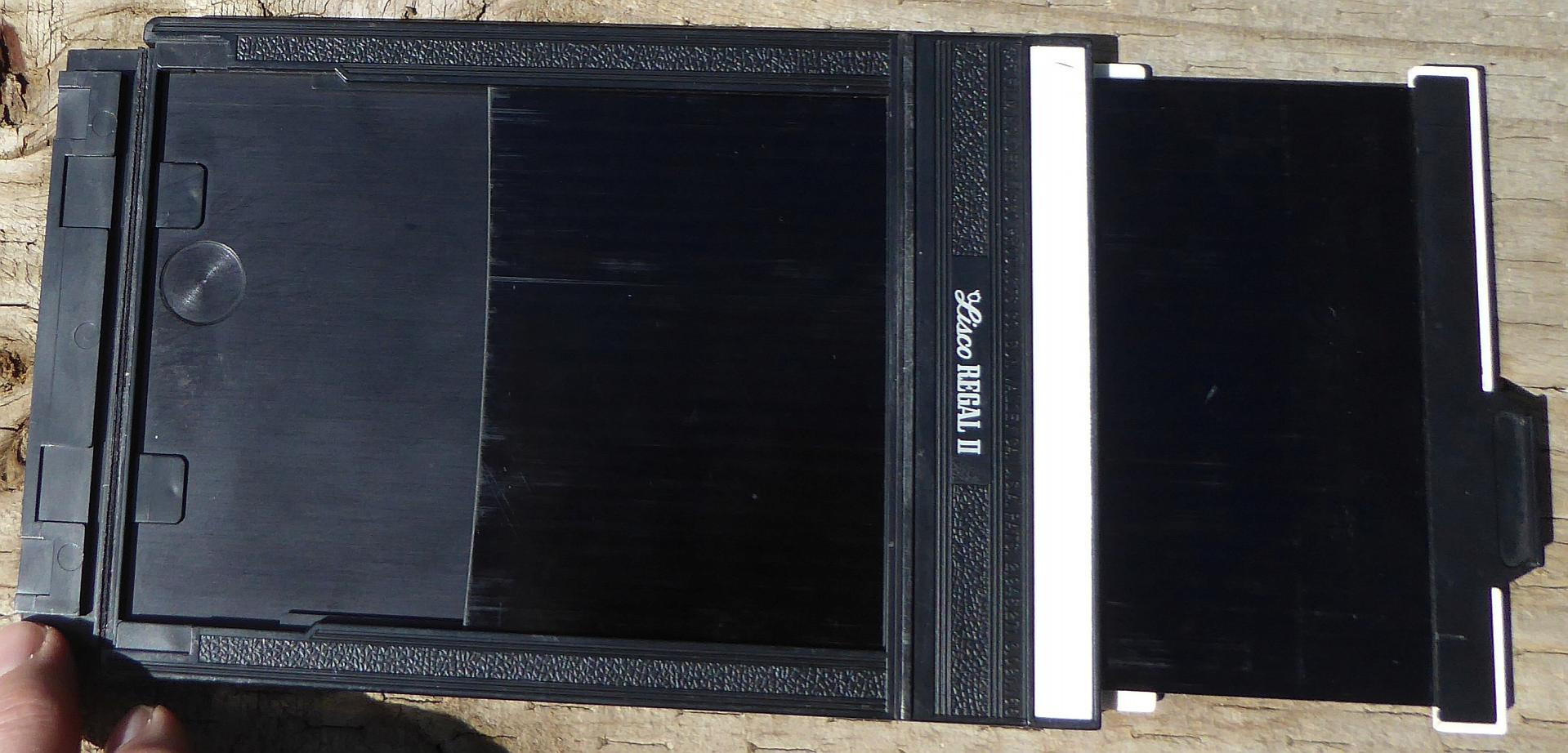

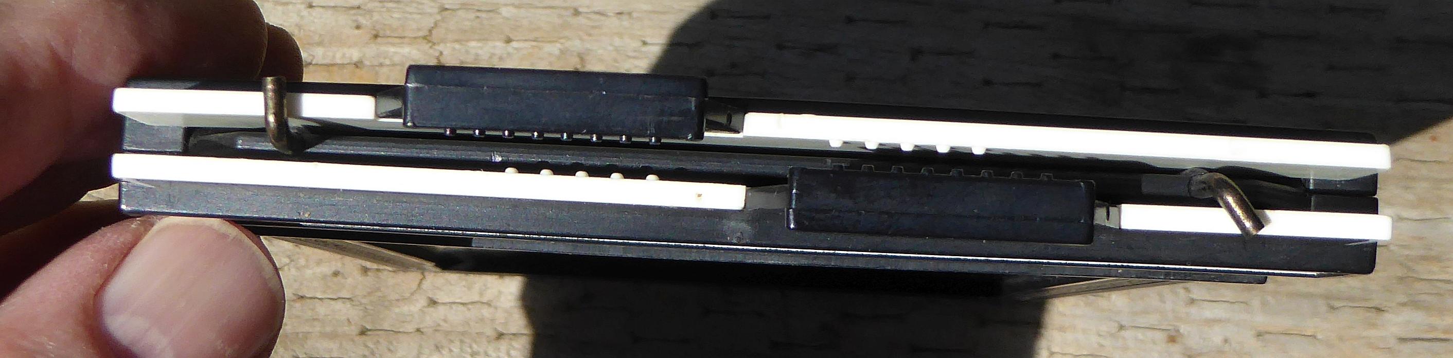

The various Lisco units I have are all good, but I do find that the easiest ones to work with and with that have the least possibility of making errors with, are their MarkII version. This is the one with the elongated top on their slides. Not only are these easier to pull in and push in with thick gloves on, they also require the pushing of the little white button (by hand) to remove the dark slide. This little button, if not pushed in, will not allow the dark slide to be pulled out. When you insert one of these film holders into your camera back, unless the holder is correctly inserted, that little white button is not pushed in and you cannot pull the slide out.
This may not sound like a big deal, but every now and then it is quite possible to insert a film holder either not quite all the way in, or, depending upon the actual construction of your camera back, you can push a little too far. This doesn't sound like a big deal, but, if the film holder is not seated correctly, when you pull the dark slide there is an extremely good chance of getting a light leak between the film holder and the camera back. These film holders do have a slight drawback, they physically take more room than the other film holders I have. Not often an issue, but if I am travelling super tight, space wise, I leave these holders home.
The other Lisco units are great with the metal topped ones being the oldest I know of, but still work very well.

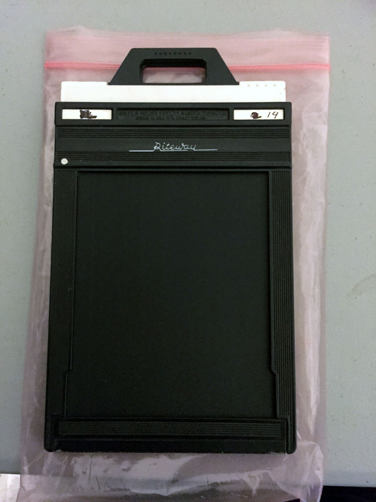

Riteway is a brand that works like that. I'm not sure if they are the same but all mine are the button style and I'm pretty sure all say Riteway. They aren't supposed to work with Linhof but they do with my Tech III (sometimes with a bit of wiggling to get the button to press in by the back.)
Roger Cole
Jan 20, 2011
6,069
Atlanta GA
Here's one of my Riteways, same basic design. Note that one thing some people do NOT like about this style is that, because of the style of the handle on the slides, they will NOT fit into a quart ziplock. This one is laying on a 6x9 anti-static bag. Someone on the Large Format Photography Forum a few years back got together a bulk order and I ordered a bunch of these that I store my holders in. They fit fine in the 6x9s.
