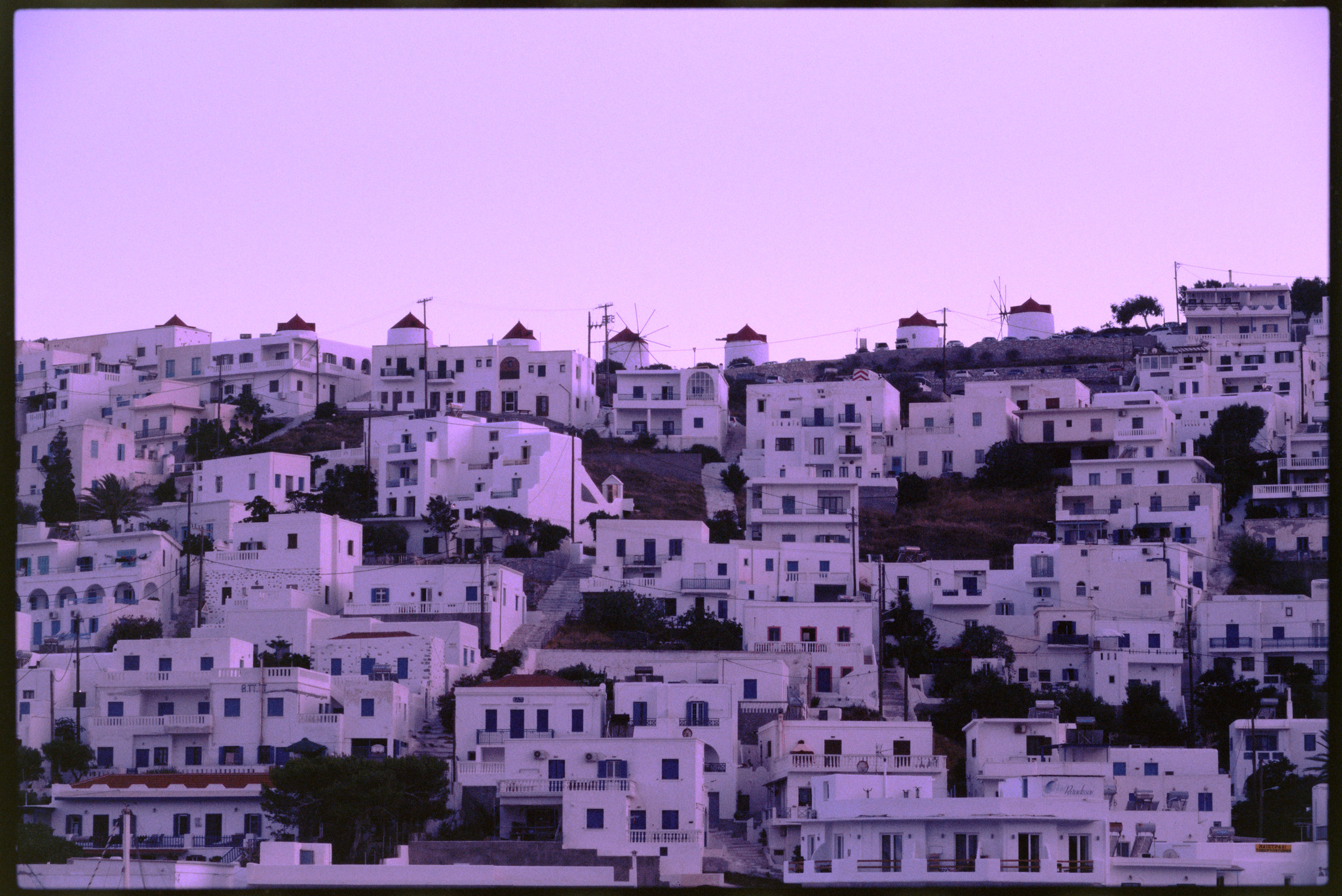

I like the look of slide film for both golden hour and blue hour. Ektachrome E100 is a safe choice, or you could go for something expired. Mild slide color casts can lend atmosphere to an image taken near sunset, especially purplish ones. You can also use filters.
Shooting C-41 or ECN-2 can lead to headaches with color adjustment, unless you get really good at that stuff.
Here is a 35mm slide taken during blue hour on '96 expired Sensia 100. I had the option of balancing out the purple or keeping it. For a while I was printing the balanced-out option, but later I decided to keep more of the purple.
