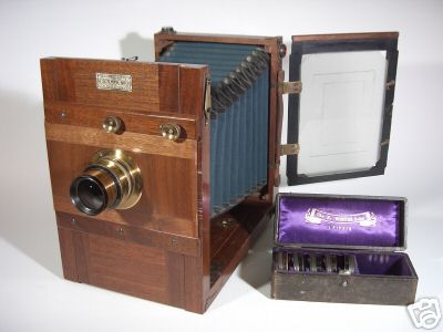

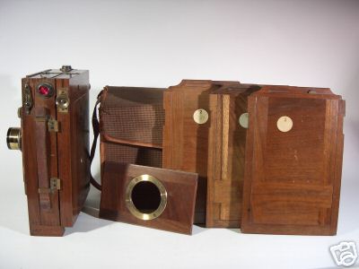

In a way you could say that the back doesn't come off - it is the camera. The best way would be to make an adapter which fits the way the plate holders do - a slide-in 4x5" adapter. The the adapter could slide out again for closing the camera.
Here's the camera - lens set not included (but replaced with a Rodenstock Recti-Aplanat No. 2). If nothing else, it is at least decorative. :smile:
