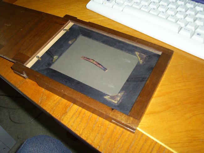

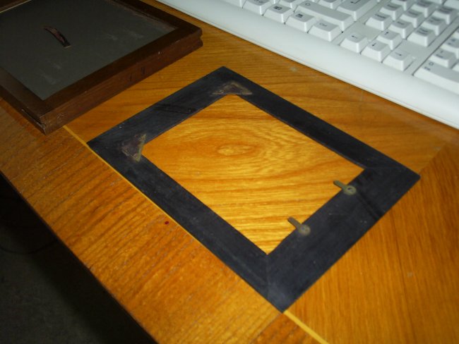

Format adapters: These are simple wooden "frames" made of very thin wood and painted black. In the corners there's a small strip of thin material to hold the plate in place. All of mine came in various old holders - including a 24x30cm to 18x24cm to 13x18cm to 10x15cm to 9x12cm set in one holder.
Film adapter sheaths: I don't think these are made anymore, but they turn up on ebay every once in a while. The largest ones I have seen are 18x24cm, I also have both 5x7" and 13x18cm as well as the smaller sizes. Note that 5x7" sheaths can be used in some 13x18cm plate holders, but not all. I have three seemingly identical plate holders for my 13x18cm plate camera - the 5x7" sheaths work fine in two of them, but the third one has an opening about half a millimeter too large. So sheath and film and all jump out of the holder when I pull the dark slide. :sad:

Just for illustration purposes, a few horrible digisnaps of a plate holder and insert (this one 13x18 cm holder with 9x12 cm insert):
