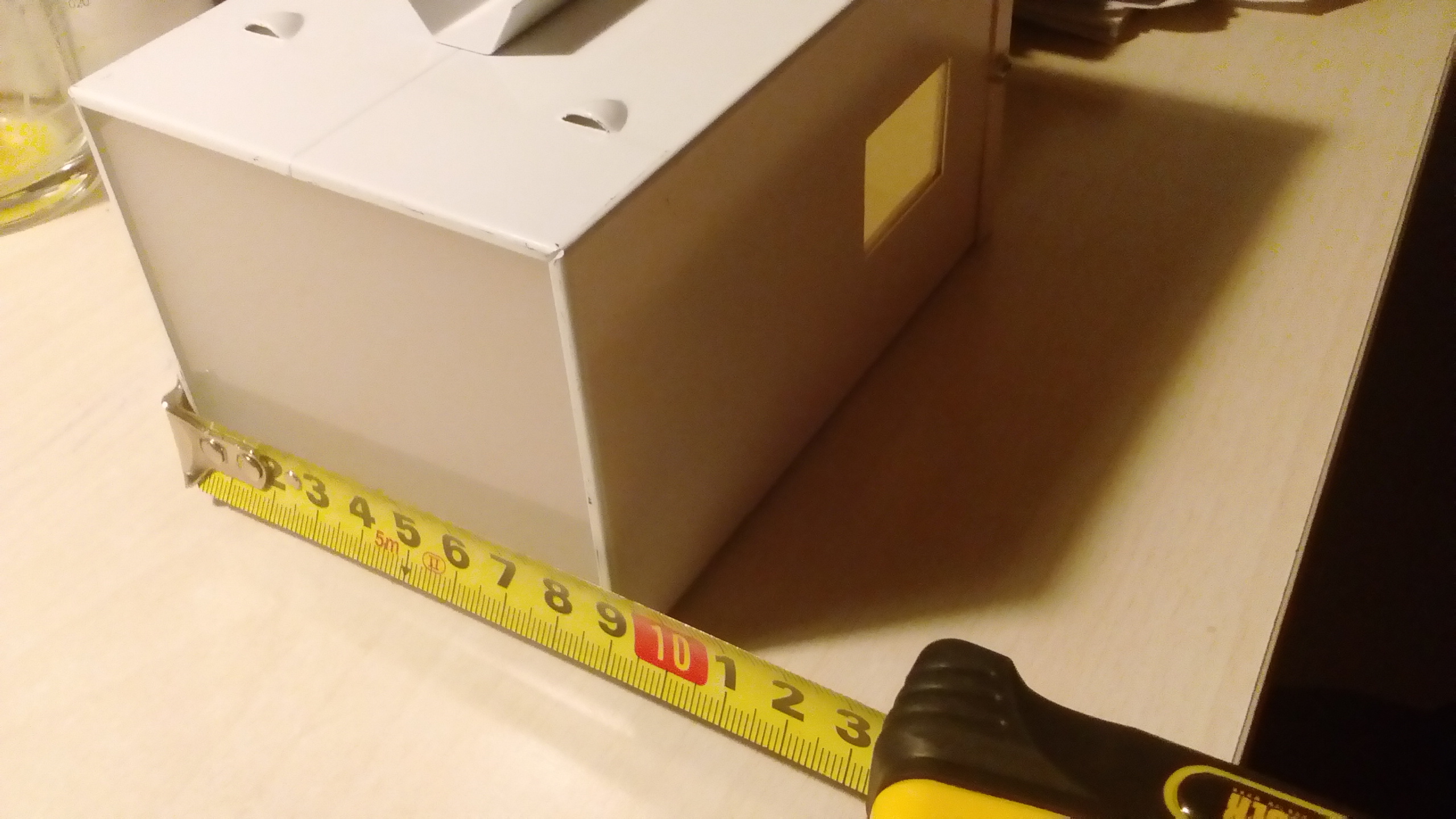

This the mixing box. Is that the 4x5" one? Measuring tape in cm
Not quite. The surface of that mixing box closest to the camera looks like the translucent part that goes down on top of the negative holder. The dimension you have measured is shorter than the short dimension of a 4"x5" negative. How long is the other side?
I'm guessing that that is the medium format mixing box (designed for up to 6 cm x 7 cm).

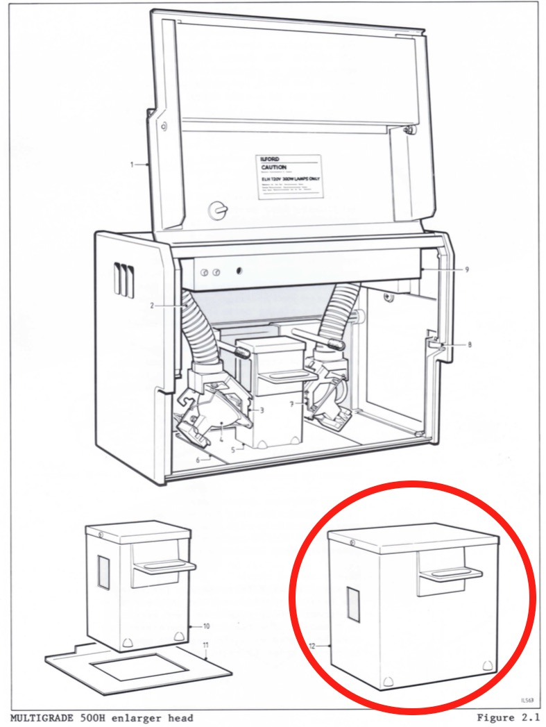

Odyssey Sales/ DeVere - http://www.deveresecondhanddarkroom.com - should be able to sell you a 4x5 mixing box for the MG500 head (probably not super cheap, but will just drop in) - that's the 6x7/6x9 box that you've got there from the looks of things. The 4x5 box is the only MG500 mixing box that doesn't use an adaptor plate. 4x5 inserts for the Durst carrier shouldn't be too hard to find, though I can't immediately recall whatever bizarre acronym they had. Otherwise, it's a first rate enlarger & head - enjoy putting it to work!

Lachlan's right....you have the 6x7 mixing box there and you'll need a flat adapter plate to use that (or the 35mm) mixing box.

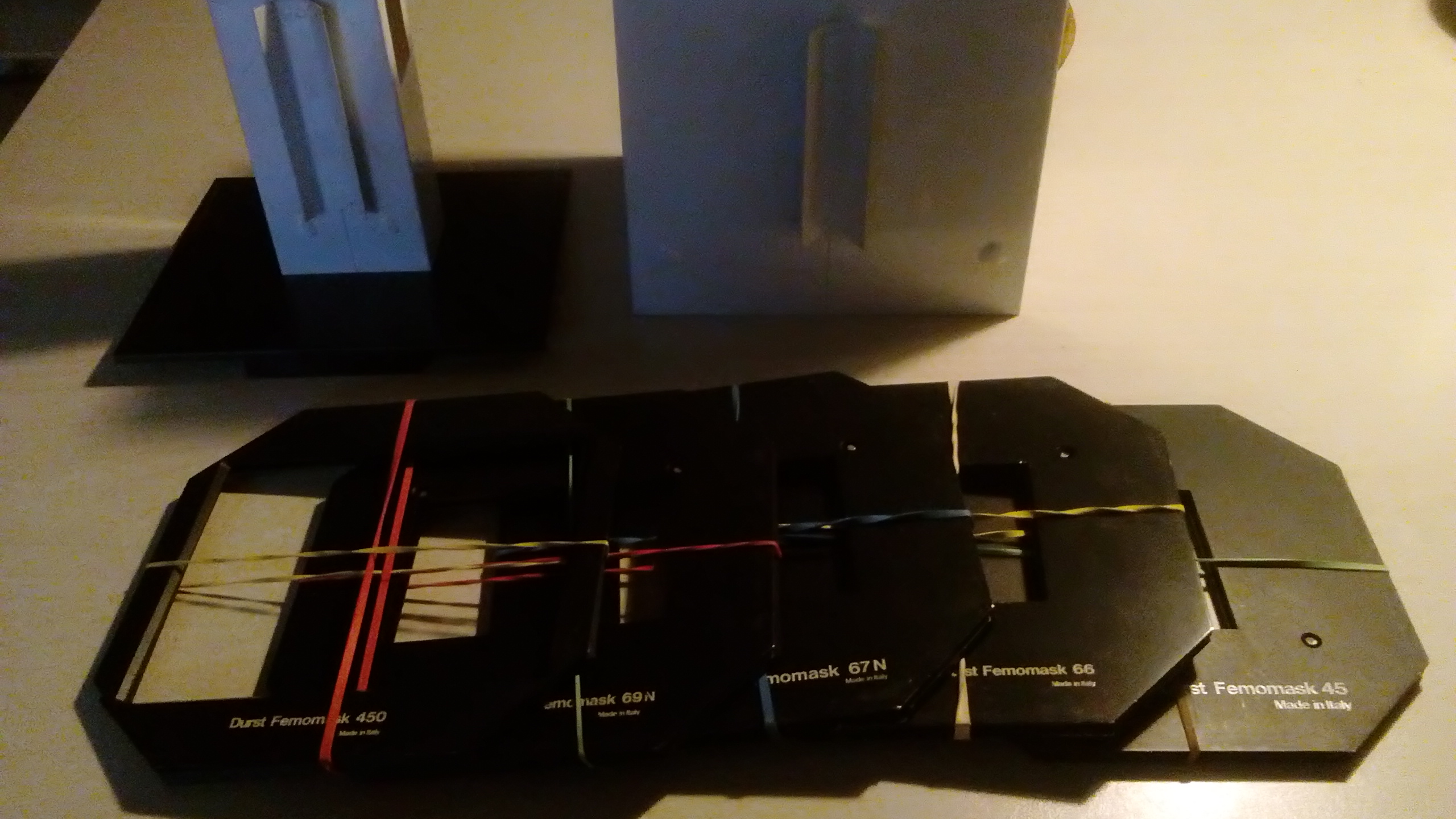

The 5x4 mixing box does not need an adapter plate. I think the neg carriers are Femomask 35/66/67/54.
Yes the mixing box sits in an adapter plate (missed that at first look and got confused) and the bulbs on either side seems to be moveable, there is some kind of rail in the back of the head.m good to know the names of the neg carriers, hopefully they'll be easier to find. A laborator 1200 as 24x36 only is such a tragic Waste.

there are three diffusion boxes available for 35mm.6x6 and 4x5;all optimized for max light efficiency.
