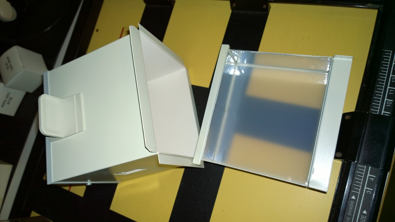

Here are a few pictures of what you need - it comes in two pieces. It took me a while to find them and think I'll hang on to these.
What you show is the diffusion installation kit.
The translucent diffuser is not used in condenser installations.
Quoting from section 2.1 of the user manual:
"For some enlargers, two kits are available; a diffuser kit (which converts condenser enlargers to diffuser) or a condenser kit (which enables the enlarger condensers, and therefore, all the associated characteristics, to be retained). In these cases, the choice of kit depends on whether the user prefers diffuse or condensed light."
This is not the same as the mixing chamber, which is what the OP needs.
- Leigh

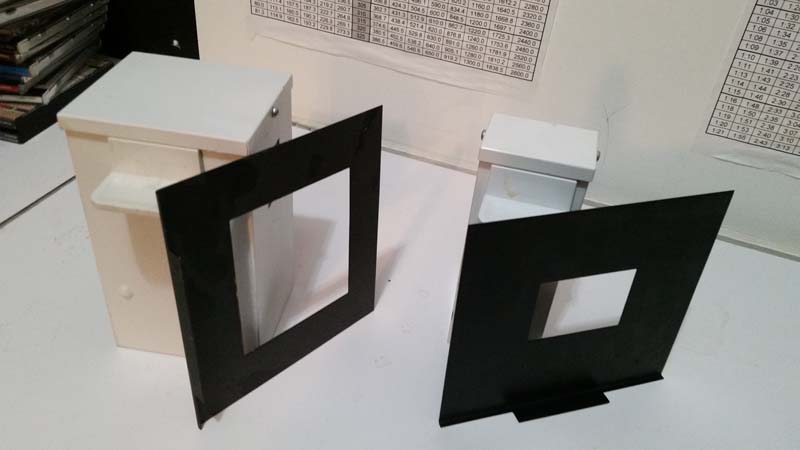

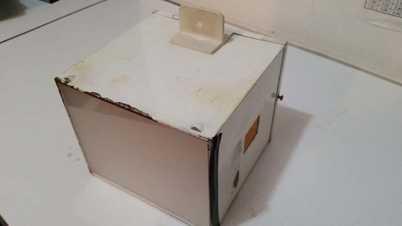

After digging out my equipment, I see I mis-spoke about my needs. I actually do have the 4x5 chamber but not any adaptor for the Beseler 4x5. Below are pictures of the boxes/adaptors that came with the ebay purchase a few years ago. There was no way to anchor/position the head to the enlarger so I did rookie surgery and screwed an adaptor ring on as shown. I'm still unsure how it's supposed to sit on the enlarger and what I might still need. As I recall, I was having trouble with vignetted corners so maybe the mixing chamber wasn't sitting low enough. Any info is welcome.

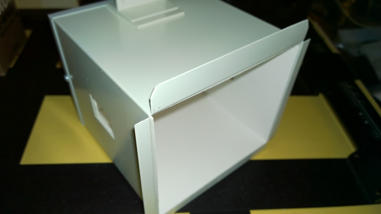

Ilford 500H mixing box for Beseler 45, the LH piece sits in the bottom of the 500H head and protrudes through the base. The RH piece sits on top. If this was manufactured as a one piece unit it wouldn't be possible to remove it without pulling the head apart.
Correct, but only used for diffuser installations.
For condenser installations the mixing box on the right is used by itself.
- Leigh

You guys are so generous taking and posting pictures, and commenting! So Paul, referring to your last picture, it looks like I have the chamber on the right but I need the one on the left. If I can't find one, I wonder if I could make a crude replacement, even out of foam core board or something. It looks like its purpose is merely to support the upper box. The upper box I have has a thin piece of white acrylic diffusion in the bottom. I wonder why the Beseler box has to be elevated inside the head, since it appears that the lower section is also inside the head. As I recall, the light bulbs inside can be adjusted up or down to shine into the windows in the box.

Here are a couple of different adapter plates, the top one is for a Beseler 45 and the bottom one was for an Omega. From memory the four counter sunk holes around the inside edge match up with the screws that hold the retaining slides in place. You remove the slides and then screw the plate in place using the same screw holes. You need counter sunk screws for this - I can't remember whether the ones holding the slides in place are counter sunk or not so you may need to buy some new ones. You can then set the head in place and screw it onto the plate from the underside. The four screw holes around the outside should line up with screw holes in the base of the head.
This is the only photo I could find of it all set up, hopefully that will make it slightly clearer. I sold that enlarger a few years back so I'm afraid I can't do any better than this. The diffusion boxes are all set up to be the same height above the base of the head so that the windows in the side of the box line up with the lamps which loosely clip to the bottom lip of the window (depending on what enlarger your head was used on before they may need to be spaced out from the back of the head to be in the correct place). The different height below the base of the head is all about getting the diffusion panel as close as possible to the negative. The Beseler box has to be longer to cater for all of that compressed bellows you can see in the photo above. You may find that you can get away with using the box you have without any major issues.
