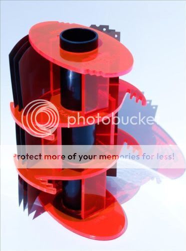

As Monito has shown my little device i though i'd show you a bit more,
have a look at this video which explains a bit more about my processor-
[video]http://youtu.be/o0Hs7DxCkBg[/video]
cheers,
Morgan.
cheers,
Morgan.
This this is just Darn GREAT!!!
does he make it himself?
