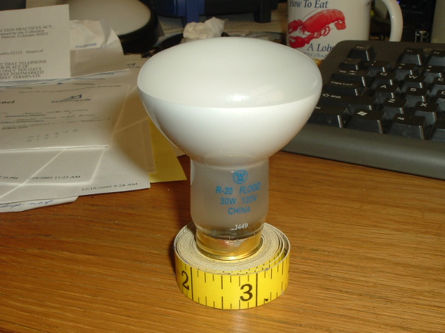

Take a look at this thread:
and the attached picture. It's a 30w flood.
The bullet reflector is 6" in diameter, and it's about 28" above the contact printer. If you tape a couple of sheets of tracing paper (or other translucent material) over the reflector, you can get exposures in the 15-20 second range.
Of course, it depends on the speed of the paper you're using. I've been using some Ilford Galerie, which is pretty fast.
Hope this helps.
Steve
