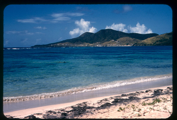

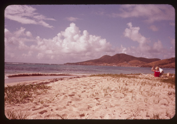

My wife bought some slide boxes at a thrift shop today, complete with a collection of slides.
Included are some Kodachromes and Ektachromes from someone's vacation, and by luck there were two of roughly the same scene.
In general, the Ektachromes look faded and off-color compared to the Kodachromes which look near to perfect. Red has survived pretty well in the Ektachromes, but the green and blues have certainly suffered.
It illustrates what many of us know already, which is the incredible longevity of Kodachrome.
The mounts on both are embossed with the month and year, Jan '60.
No color adjustments in scanning or PS.

What an amazing find. Do you know the location? Hawaii maybe? California coast?
I gather they weren't exactly stored in a climate-controlled cave somewhere--the Kodachrome looks great. Damn shame it's slowly--or rapidly--following the dodo into extinction.

The point isn't so much to criticize Ektachrome of 1960, but more to illustrate how good Kodachrome is. The chance to see a side by side comparison of the same subject is kind of rare.
Certainly this says nothing at all about the longevity of Ektachrome that one can buy today. As Pupfish points out, Kodak, and Fuji are quite serious about the longevity of the materials they make and, have the benefit of 60+ years of learning. The oldest Ektachrome slides I shot are from the late 60's and 70's, and the last time I looked through them they were clearly degrading, though they still retain most of their original look. My Ektachrome shot from the 80's on look good. Aside from not using PVC my storage is far from archival.
As for Mike's question, "Buck island trip" is penciled on some of the mounts, according to Google maps, it's in Bermuda.
And yes, if I could shoot some Kodachrome in 120, I'd consider my life complete.
These were purchased in a metal slide cabinet, and the slides themselves are in Yankee plastic projector trays, probably made from Bakelite, but I've not looked at the trays closely. Other than that, I think it's safe to assume that the storage conditions were anything but archival.

That Ektachrome looks absolutely wonderful compared to a few that I have. They've gone entirely orange on me! Those must have been stored in a climate controlled room compared to mine.
Does it say Ektachrome on the mount? It looks similar to some Anscocolor slides I have, they have faded, but there is very little color shift, only a loss of density over all.
Taken a second look, definitly strikes me as an Anscocolor, the shift is not as bad as E-2 and appears to be faded over all.

Yes, they say "Ektachrome transparency" in blue lettering on the mount, and "Kodachrome transparency" in red.
Except for attics, temperatures here are pretty moderate. Indoor air is pretty dry due to heating, summers are humid, but not anything close to that of the south U.S.
Air conditioning is not common. Things like this often get stuffed into basements, which would be a pretty constant 50 - 70 degrees (F) and moderate humidity.
But I'm only guessing at the conditions these slides enjoyed.

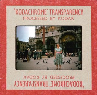

My other question is about Kodachromes in grey cardboard mounts with a red border. I have 4 like that in the first collection I mentioned, and I guess they are earlier than the ones in white mounts with the red and yellow Kodak graphic in the corner. What year did that change?

Very useful, thank you. The slides I mentioned say they were processed by Kodak and are just like the ones shown on that page from 1955 to '58. Most of my undated collection is made up of the white/yellow/red types and they are Kodachrome, not Kodachrome II (which I understand was introduced in 1961), so that ties up with the royal visit to Naples in '61.
