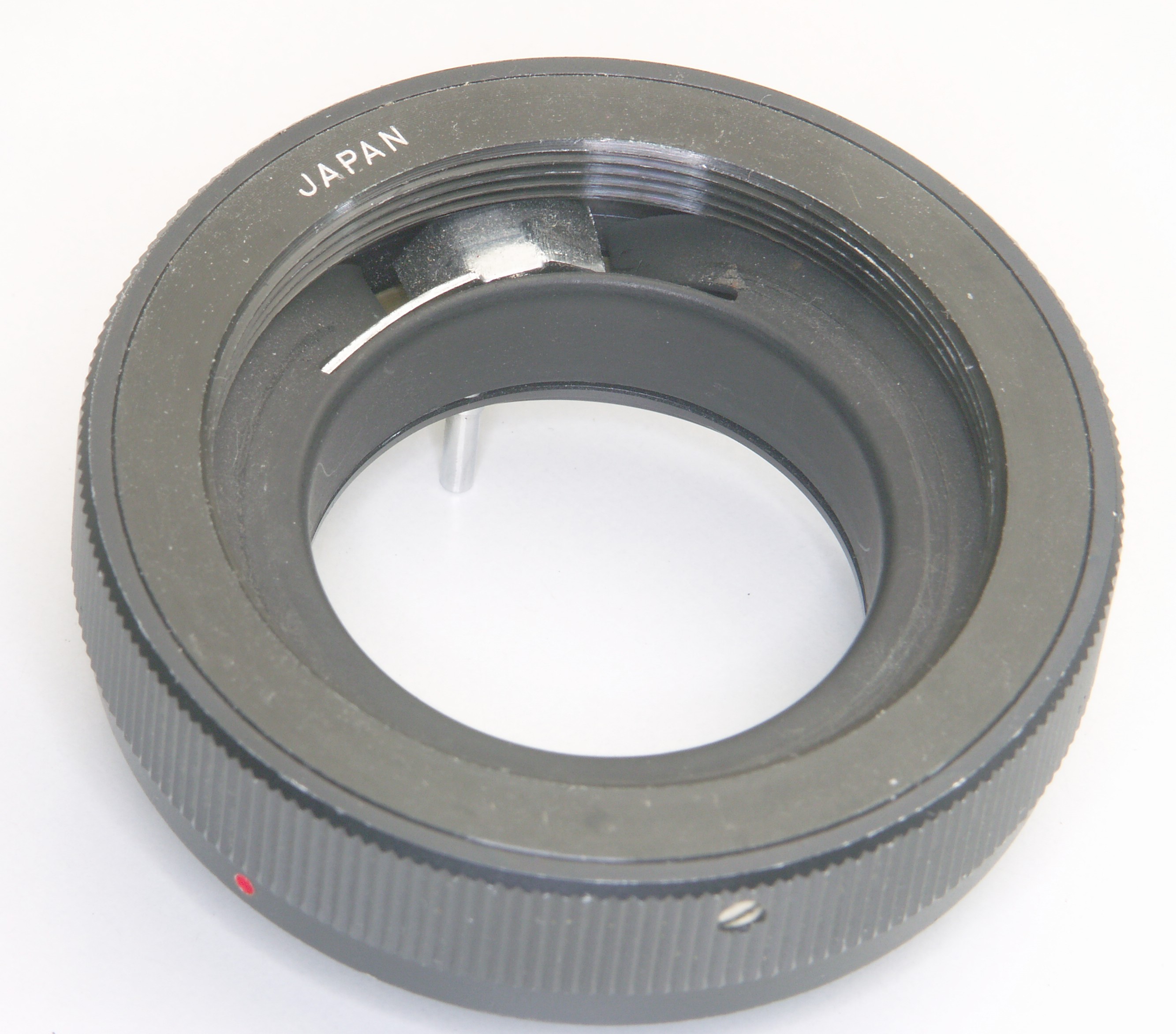

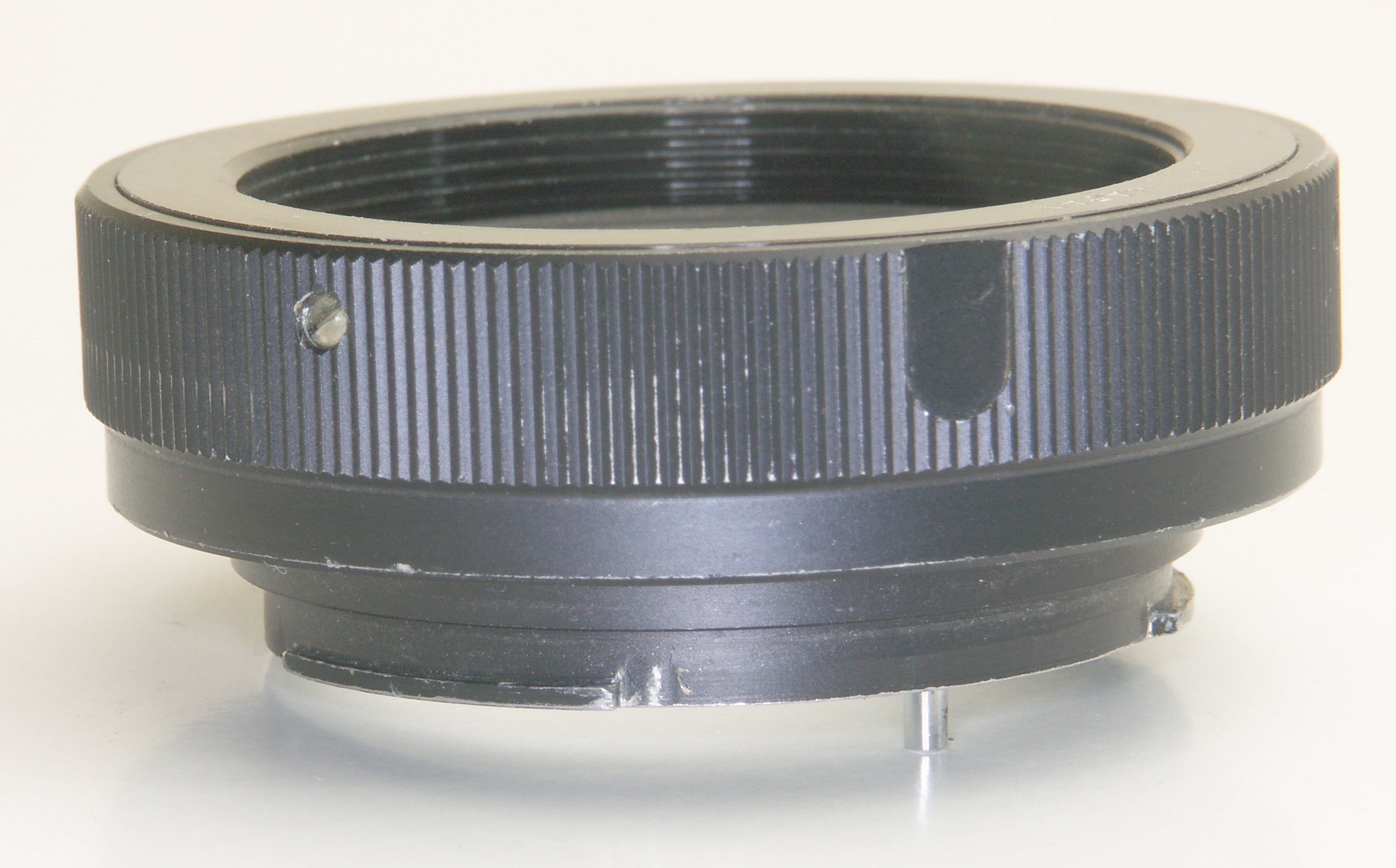

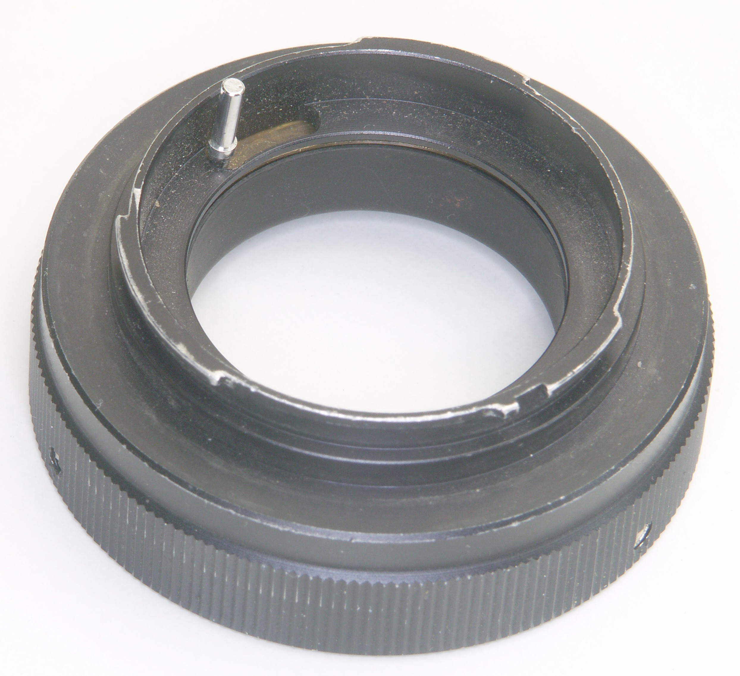

Here are photos.
From the side it looks like a T-mount to Minolta adapter.
The rear shows the Minolta SR mount with a pin that is pushed by the aperture lever in the camera -- to stop-down the aperture in the lens (which t-mount lenses DO NOT have!)
The front shows the 44mm screw-mount -- not a 42mm T-thread -- AND the silver tab pushes in on a pin in the lens -- a lens with a 44mm thread.
BEATS ME!!!!

Thanks to someone -- apparently not on this FORUM -- I've been informed that my mystery adapter is a "T-mount" even though it has a 44mm thread. But it is NOT a Miranda product as I originally supposed.
Back in the '60s, Kalimar created their own "T-mount" with a 44mm thread -- and lenses from 25mm to 400mm to go with it. The main difference was that it included auto-aperture control -- which needed a couple of extra millimeters.
That's what this mystery is:
Here's where I found additional info:
http://forum.mflenses.com/auto-t-the-most-obscure-interchangeable-mount-t10869,highlight,kaligar.html
I'm not going to run out and buy any Kaligar lenses, but I'm sure someone has an interest.
