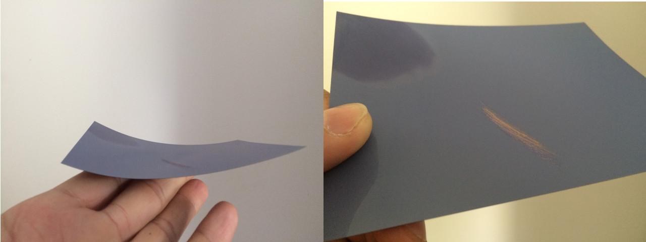

Testing on a sheet, the purplish side is indeed the emulsion: color change after humidification, and scrap goes through a layer of emulsion. The curl is the hint also.
My pack had been opened so I can't confirm if it is by default, but there is a thin yellow paper under the one fold of the enveloping cardboard and the emulsion side of the sheet on top of the stack.
Anyway the curl is easy to feel in the dark. And a notch can be done on the stack with two small cuts of a sharp blade.

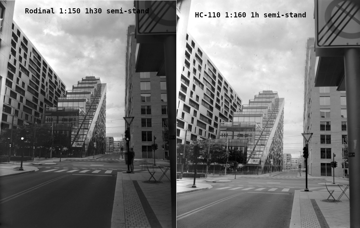

I metered at iso 2 and used Rodinal 1+150, actually rather 7ml + 1 liter water, 1hr30' , agitation the 1st minute, then 10s at 30' and 60'
citric stop, rinse of the stop, regular acidic fixer (Fomafix) double bath.

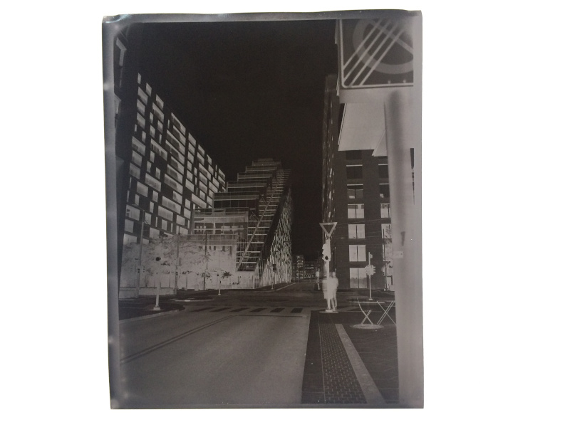

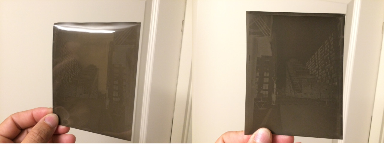

negative is dense brownish:
but looks good under lightboks:

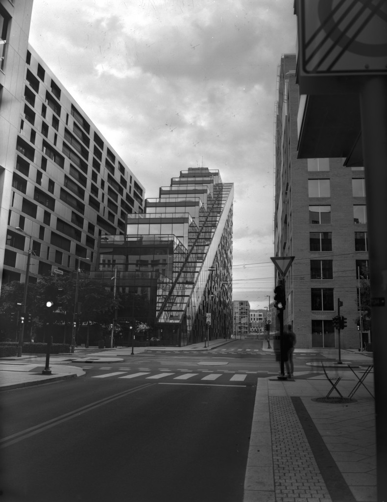

inverted/"printed" as regular grade 2 paper in ColorPerfect.
Lense Topcor 105mm f4.5 at f16 for 4".
I am standing in the shadow between two buildings, the half-pyramidal stairred building side is very dark/black tainted glass:

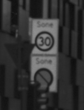

100%:

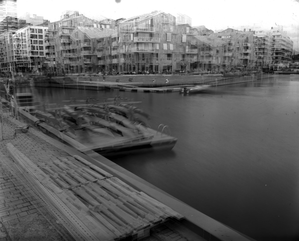

this one is botched, a double exposure. I was unsure if the shutter had triggered, and decided to take again after I checked shutter was ok and in doing so moved a bit.
But the point with this shot is that the background houses are all shades of light and mid greys. foreground kayaks are yellow and bright red.
Same Topcor-105f4.5, 8" @f22
these pictures were taken in double, so i have the two other still in the holders, and wondering what other recipe and/or developer to use for comparison and possible more optimal result. No idea how much of spectral range can be extracted,since this film anyway was meant for mechanical drawings (strong bw contrast and lines).
I have Rodinal, HC-110., Tetenal Ultrafin, XT-3, Tanol ....

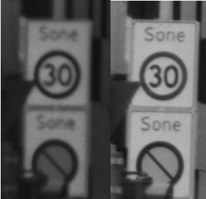

still haven't decided what to try with the two sheet waiting to be developed. Maybe Rodinal again, but full standing, no inversions after initial agitation, 1+100 for one hour, or 1+200 for two hours. Or HC-110 1+160 45mn semi-standing.
removedacct2
May 26, 2018
366
thanks for the hint. i have still some Moersch Tanol in the fridge, so could try that, and also buy some of his other staining developers (Pyro 48, Finol, ...). I can't see Pyrocat powder kits or concentrates sold here in Europe, would have to mix from raw powders.

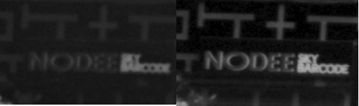

otherwise I tried HC-110 1+160 1 hour semi.-stand (5s gentle inversions at 30'). Exposure isn't exactly the same for the two shots, there's always some small difference when using stopwatch and cable manually, in this case the meter said 4s but there may be quite some ms +/-. But 200% details show more sharpness with HC-110.
