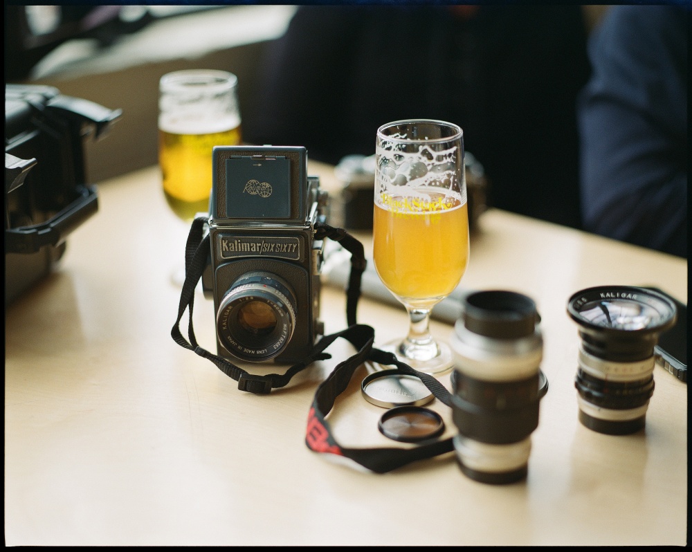

Here's a shot of my Kalimar Six Sixty
The 52mm covers 6x6 just fine, the image is a little soft, but I was shooting with a slow shutter speed.
