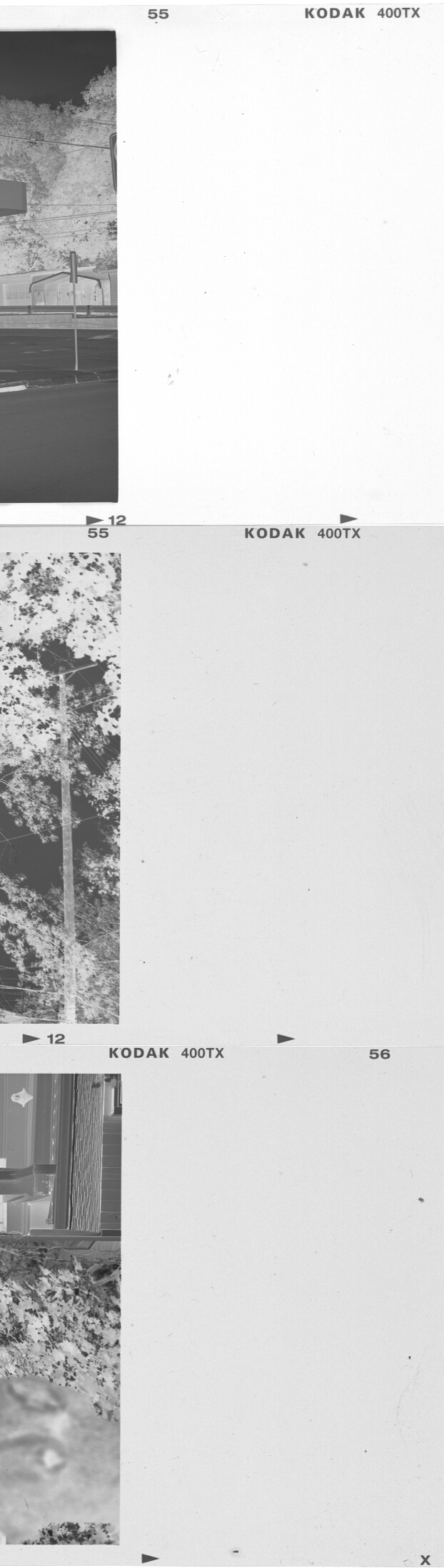

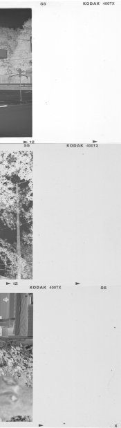

Two boxes of 5 rolls of Tri-X 400 film have been bought, shot, and processed. The second box came from a different batch than the first. The codes are different on the boxes. Both are within expiration dates. Both were developed identically. Both are different. The older box is much darker.
Is that a normal thing?
I thought that because I ran out of distilled water that the film got darker. Not so. The test roll I shot used distilled water for everything and the darkness remains just like without it.
What is going on?
I thought that film would be the same if you processed it the same.
I suspect storage temperature may have been different at some point, though I could be wrong.
Sent from my SM-G900V using Tapatalk
If the tap water is potable then NO the water did not cause what you saw.
You got it fogged somehow. Don't blame the film itself.
Shutter running slower if rebates are the same?
If rebate printing darker bad developer package.
Bad film normally fogs so shadows and rebates would have silver.
If the rebates have non uniform silver or yellow tint your fixer kaput.
The new Tx needs more fixing...
In most cases either light, heat or radiation (from gamma rays) cause b+f increases.
They may print identically.
It would be interesting to try re-fixing the darker version.
I knew I would get blamed for this. I didn't fog it. It came from a refrigerator and straight into the camera the next day. I suppose the dealer had it sitting out a long time before putting it into the frig. Not fixing enough leaves the negatives pink. That goes away with 1/2 hour of washing but not with more fixing. I'll try more fixing on the dark negative to see if it lightens some. Printing times are different but quality may turn out to be the same at the different time of exposure. The same developer was used, a new batch.
Fog can come from heat, radiation and a combination of factors that are exacerbated with age. Based on your later post, it seems that the darker film is more than two years older.
Both may be fully within specs with respect to all the important criteria - how they record light, and print.
Yes, I don't think it was any fault of yours, but the film was not under your control always. It appears uniform which is why I suspected heat fog. I used to flash my copy neg stock to reduce contrast. It will probably print just fine and give you a fraction more time to dodge and burn the print.
