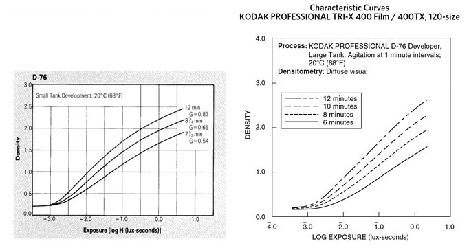

Tri-X is almost the same as Neopan 400. Grain wise and resolution they are nearly identical, but their tonal characteristics are a little different. The Neopan has a bit of a shoulder that could make life difficult for you if you don't watch it in film processing. Tri-X is more linear in its response and therefore a bit more forgiving in its nature.
But it's undoubtedly a really good substitute.

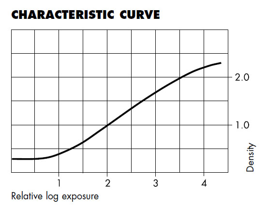

Actually, you might wish to give Ilford Delta 400 a go. Its characteristic curve looks more like Neopan 400 than Tri-X 400.
There is a slight shoulder with it. Not as much as Neopan 400, where the whole tonal curve from mid-tones and up is shouldering, but there is a shoulder at the top.
- Thomas

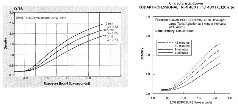

Thomas, Neopan does have more shoulder than 400TX, but not as much as the graphs show. You see, in Kodak's chart, the Y axis scale (density) is longer than the X axis scale. If you "normalise" it (compress image at the Y axis by 20%) 400TX will have more obvious shoulder. Still more linear than Neopan though.

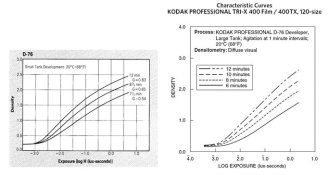

Yes, you are right. Here is another picture where the scale of the Neopan has been compressed to the exact same height and width as the Tri-X. And I think the difference is still clear.
I was merely pointing out the difference between the two. If you severely overdevelop Neopan 400 it will block up like a bullet proof vest. Tri-X is not so sensitive.
- Thomas

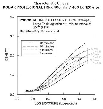

Here is a version of the graph where I superimposed the Neopan 400 curve directly on top of the Tri-X 400 curve. It's a little clearer this way.
The scale on both X and Y axis have been aligned before the superimposition.
Pardon my terrible Photoshop skills...
I hope this illustrates better the differences between Neopan and Tri-X.
- Thomas
