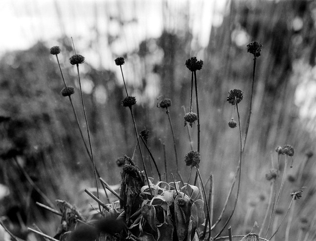

I have some 3X4 Versapan, not sure when it expired. It did have some spots I had to clean up. I've only used a few sheets so far so the jury is still out.
Camera: Graflex Pacemaker Crown Graphic 34
Lens: Carl Zeiss Jena Apo-Tessar 30cm, f/9
Film: GAF Versapan Type 2831, expired 9Unknown date)
Developer: Rodinal 1:50 for 10:30 minutes.
Exposure: f/16, about 2 seconds
Winter Garden by Bryan Chernick, on Flickr
