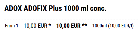

Ok so this is mad, and I know I shouldn't have been doing this but here goes. I bought my bottle of fixer concentrate in January 2022 when I first started developing BW film (Adox Adofix plus), knowing it could last me around 1 year max. I have been keeping it in the dark and in a somewhat controlled temperature environment. The thing is, even after a year the working solution was still going strong: film goes completely clear in around 20 seconds out of 4 minutes of expected fixing time. I'm not a frequent shooter, so I never completely "discharged" a working solution, but I thought it would go bad after a few months and be forced to mix again.
Well, it's been 4 years now and I have only ever mixed the working solution three times. Never did it run bad, it still kept clearing the film in 20 seconds, but I felt bad keeping it for more than a year. I mix the working solution with distilled water and keep it air tight. I test the working solution every time I develop.
The 4 years old concentrate is not air tight, and it shows no precipitation whatsoever, it's still clear as day.
I know the fixer does not only clear the film but it also preserves it, so what should I expect? Will my negatives tragically disappear eventually? I probably should have tossed it way before, but I just didn't have the heart as it is serving me so well!

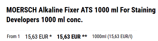

Moersch states that their ATS alkaline fixer concentrate can last from 5 to 8 years once opened
I really wonder why that isn't more popular, are there any downsides compared to acidic fixers?
I think there's your answer. And of course, Adofix in 1000ml bottles isn't necessarily the bottom end of the market, either.
The thing is, there's just very little advantage to an alkaline fixer.The "For Staining Developers" is arguably misleading since staining developers really do not need an alkaline fixer. It's a myth that just won't go away.
