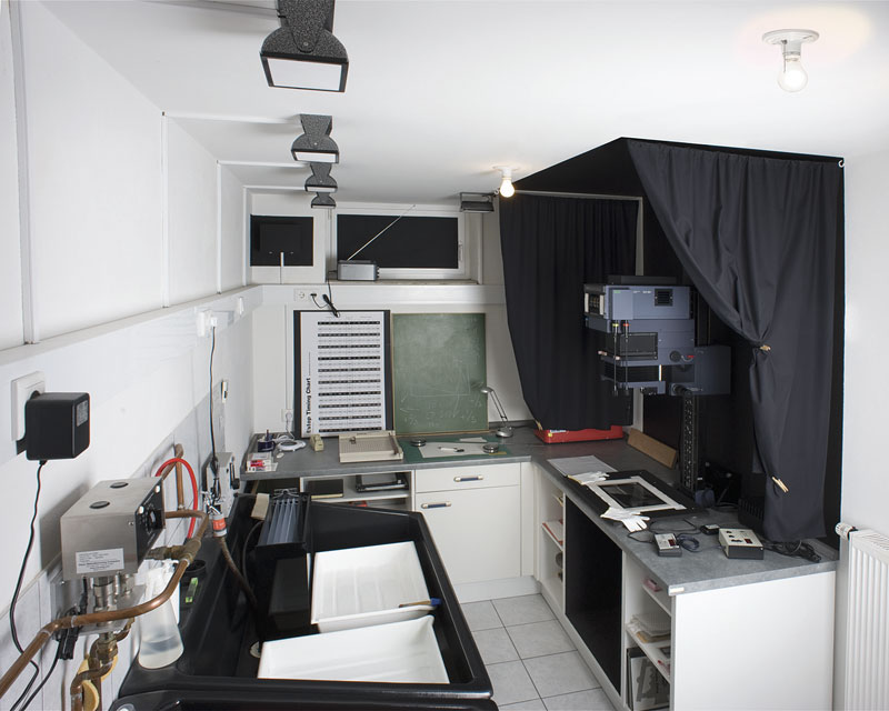

RalphLambrecht
Sep 19, 2003
14,658
K,Germany
