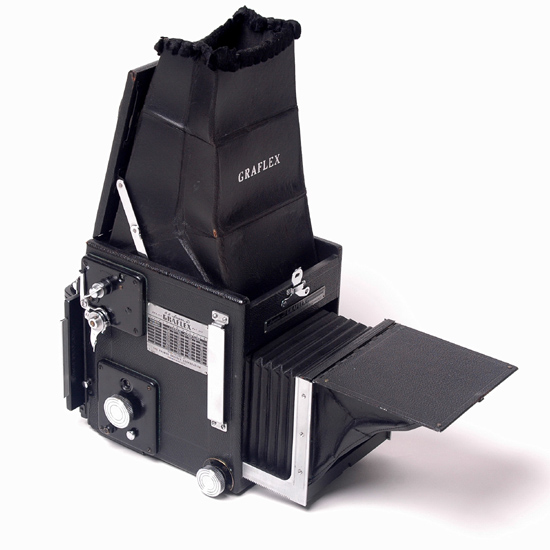

I have the same camera -- it was a gift about 5 years ago. My only hint is to make sure that you have the shutter tensioned at the right setting. Mine has the graflock back, so I also have a Singer rollfilm adapter for 6x9 size negs. Pretty amazing camera, and of course, anyone seeing you operate it will be very curious about it.

hey jay
i have the 4x5 version of your camera :smile:
it is a really fun camera to use, but kind of awkward at times.
it is a pleasure to look down the chimney and see and image right side up, but the trade off is remembering to stop down after you focus (if you don't shoot wide open that is), and to remember to re-wind the shutter after you expose.
not sure how much your mirror 'slaps', but you can release the mirror without the shutter if you want to ... i know mine makes a heck of a racket when it goes up ... when you store it, make sure all your tensions are "0"'ed out, you'll stretch out the springs....
good luck!
-john

Jay, you may want to watch on eBay for a bag mag or two instead of converting it to use regular holders. 12 shots in one holder is a nice thing to have. With my 2 bag mags I have 24 shots before reloading anything. Now if the J&C 400 would hurry up and arrive in 3x4....

Bag mags are great, and are simple to use. You take the shot, pull the rod on the bottom to move the septum most of the way into the bag and then pull it the rest of the way with your hand using the bag, and then slide the septum into the back of the stack. One attraction of bag mags over Grafmatics is that the bag mags load from the back, so that if you don't shoot the whole stack, you can easily remove the exposed sheets from the back of the magazine, without disturbing the unexposed sheets.

I have, and love, a 3x4 Graflex, too. The Super D model has two advantages over the older ones, namely a Kodak Ektalite ground glass (Fresnel screen), and a semi-automatic diaphragm (which is a damn good thing, since it's nearly impossible to reach, or even see, the aperture ring). Two of my three bag-mags were still NOS in their original boxes -- sometimes the lifter rod sticks and they have to go to the darkroom. Many were sold with the semi-auto 190mm Ektar (from the 4x5 model) for portrait use. I always wanted one, but they go for big bucks on ebay when they do (rarely) come up. I hope you enjoy yours as much as I have mine.

Welcome to the world of the graflex slr! I have a D 4x5 and an RB auto 3x4. These are great cameras, a lot of fun to work with and work on, I've repaired various things on mine, reset the shutter tension etc, you'll find they are very simple and friendly to work on yourself. There are some great lenses out there to play with, and often quite reasonable as they don't have shutters. A graflex gallery would be great, I'd put some stuff up there. I use grafmatics with the 4x5, and some regular holders, and I have a roll film back for the 3x4. I've also used a bag mag in the past, but not recently. Make sure the bag is clean, and the inside of the camera too, they can get pretty dusty. If you haven't seen it already, check out Graphic Graflex Photography by Morgan and Morgan. You may be able to find it at your library. A good resource and insight into how things were done in the 40's.
