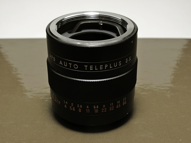

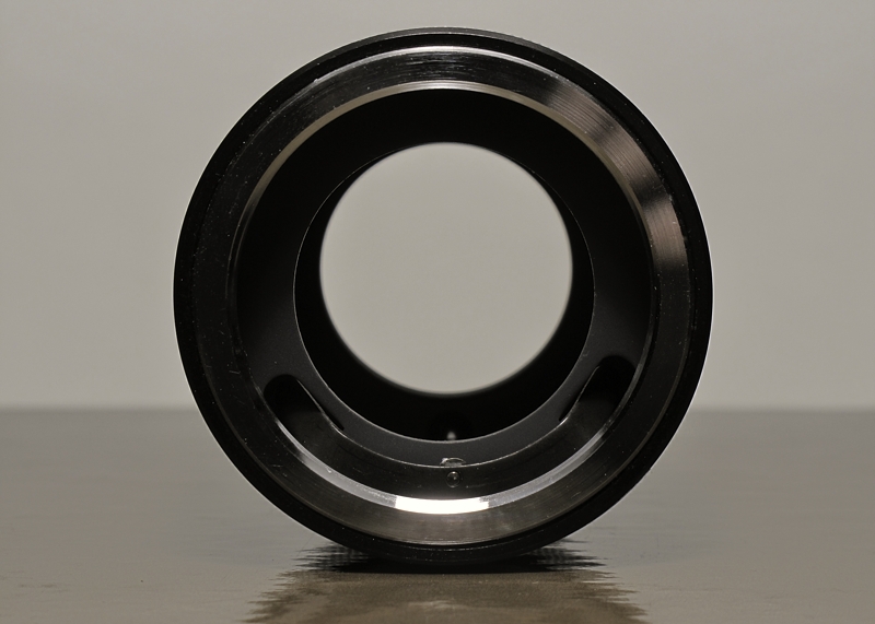

When I purchased my Spotmatic SP ll included along with 3 flashes, a dozen filters and several other items were 2 Kenko Auto Teleplus converters in 2X and 3X. The instructions claimed "even at open aperture there is no softening of focus or deterioration in resolving power so that two TELEPLUS units can be used in combination." A mighty bold statement I think. I never tested their theory, instead I got a small screwdriver, disassembled the innards of the 3X and now I have a 55mm meter coupled extension tube.
Just a thought.
