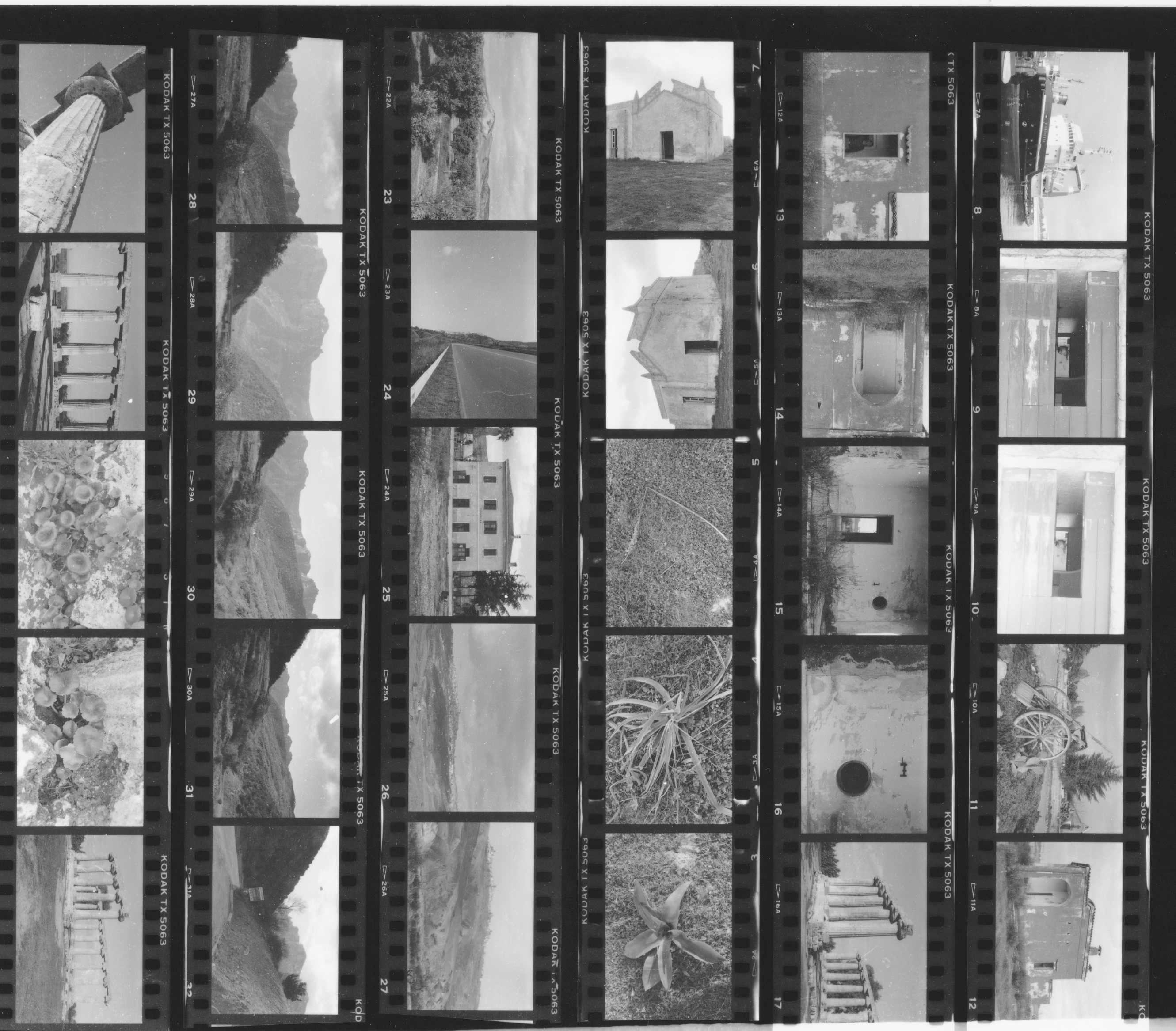

I use Ultrafine and Multitone, right now have a 250 sheet box of Ultrafine 8X10, for my purposes it's fine, right now I am making proof sheets for negatives that for what ever reason I did not make proof sheets at the time going back to the 70s. I follow up with work prints before making presentation prints on Foma FB VC. I'm using Clayton P20, works fine, in the past used Dektol, LPD, standard stop and fix, I generally print contact sheets grade 1 1/2 or 2.

I've print work prints grade 2 to 2 1/2, but if needed I do print grade 3 and 4, both Ultrafine and Multitone print well at higher contrast. I don't split print, so don't know how well they would do in that regard. You might to check on shipping costs, B&H New York, Ultrafine Photo Wearhouse is in the LA area.
