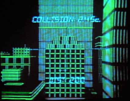

To be more specific I want to replicate something like the Escape from New York “computer graphics” sequence, where John C. Wash wireframes a city model up with Scotch Bright tape.

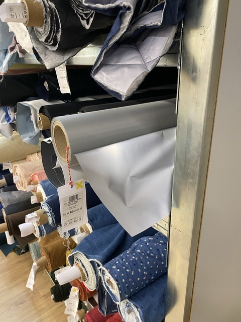

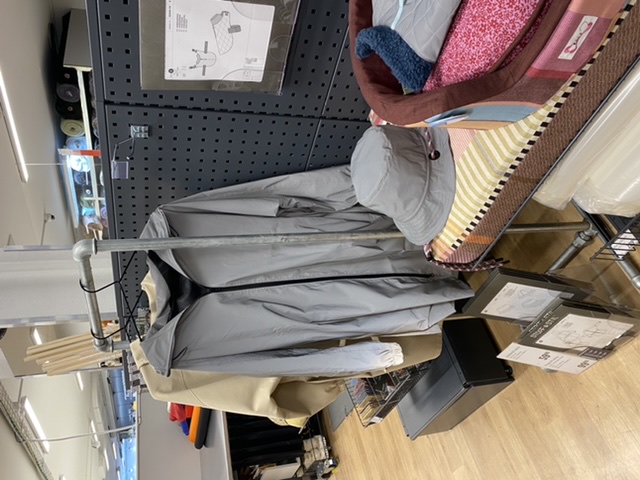

I actually found some sources, not really of tape (yet) but of very reasonably priced fabric and fabric band. Turns out one of my local sewing and fabric shops has a few choices.
It was, as suspected, a matter of finding the right search words in the right place:
https://www.stofogstil.dk/produkt?Search=refleks
https://www.slojd-detaljer.dk/produkter/?search=refleks bånd
http://reflekstape.dk/shop/frontpage.html
The gain might not be the highest, but good enough for my purpose.

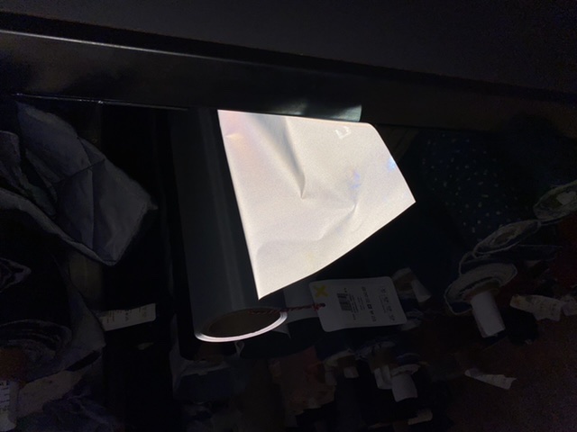

Here is a few sample shots done in the store very simply with an iPhone with and without flash (I have no idea why the last three are rotated):
There is also non stick tape band of the same material, that might even be preferable in some instances if you don't want glue and want to reuse the material.
All of the sticky tape I looked at, had the same or all of the same problems of having segmented hex or square segmentation of the RR coating, being too stiff, and being priced for someone who just needs a meter or two, to cover a bike or railing and have it stick permanently.
Ideally I'd want something like masking tape that is easily ripped and cut.
Might have to just fish a bit around and get the least worst. :smile:

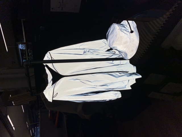

Notice the feline eyes "betraying" the effect.

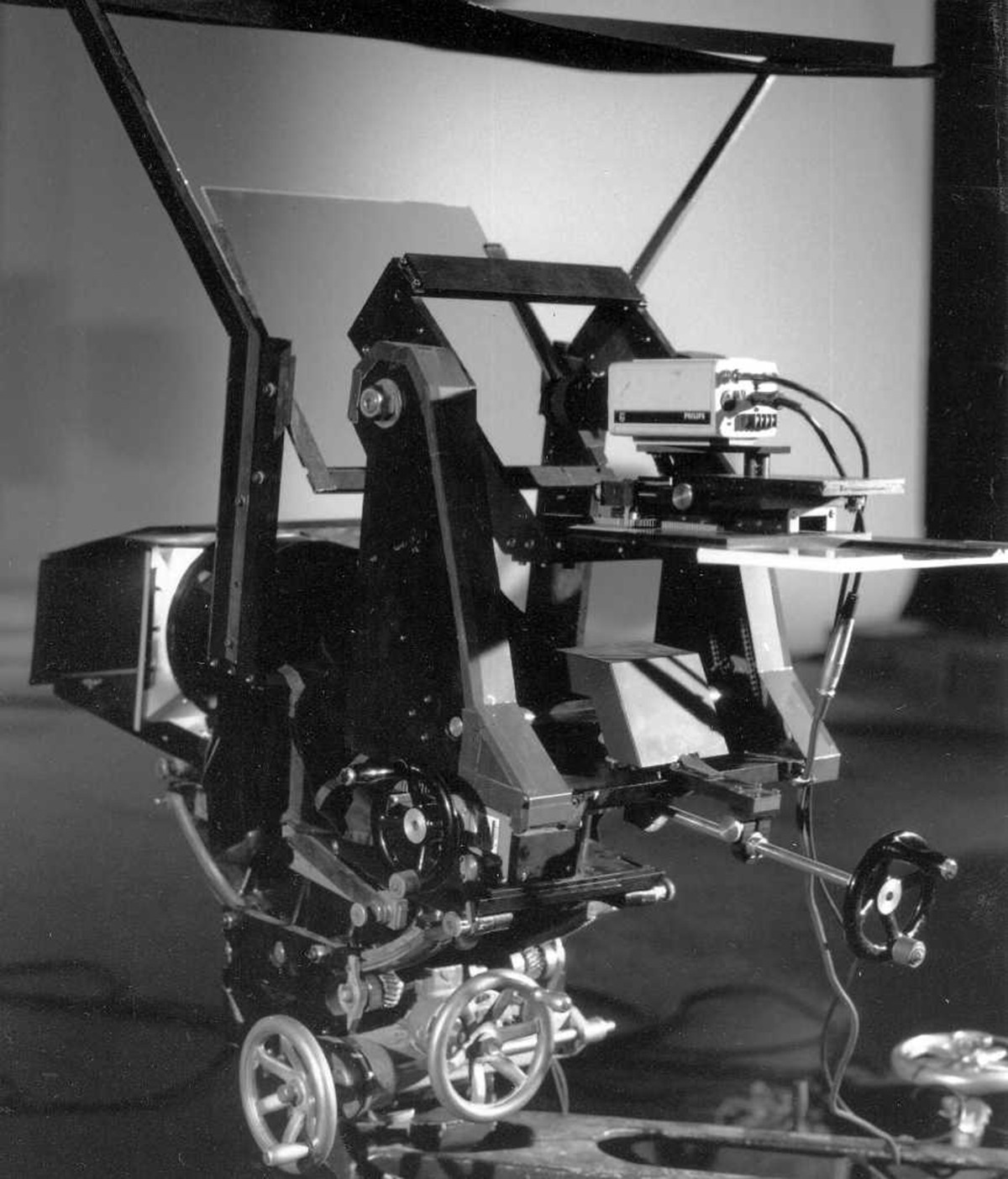

Beam splitter for very high gain and alignment, video tap and repeatability, and ability to zoom and turn was what made the Zoptic system a behemoth. Not what you really need for stills.
Some examples of RR for the luminous effect.
