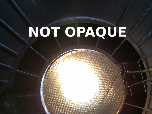

This test is for PLA filament, but probably could be adapted for other types. I used it to determine the thickness of a PLA lens board.
Note that for something like a film cassette, the opacity requirements will be more strict than for a lens board given the typical duration of exposure.
There's certainly merit to @F4U's suggestion to augment the print with an extra layer that adds opacity. Spray paint is a possibility; so is some kind of film/tape. Tin foil is opaque.
As to prints, note that the printing method will have an effect, too. A filament printer will generally perform worse for the same wall thickness than a resin printer, assuming the same opacity of the printed material. Filament printers tend to leave gaps/thin areas where the strands touch.
